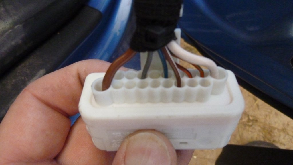

Hi,
I made a Door warning light for the GEN2 module FRONT door and it is work well.
I need help for the GEN 2 module wiring for the REAR doors. I don't find the pin out wiring for the REAR door.
Here is my connector picture from REAR door.
Can you help me ?
