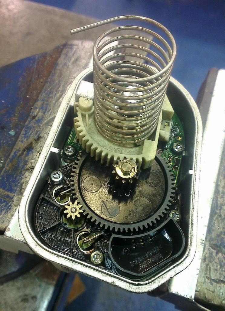

I asked if he had the old ASV as I wanted to take it apart to see what actually fails. This gave me an opportunity to get some photos so those on here can see inside one if anyone was interested in why these things fail.
There is only one way into these unit and that is to prise the grey metal lid off with a screwdriver. When manufactured it is put on the peened over in a few places to hold it in place.
Once opened I could see straight away what had happened. As suspected some teeth had broken off the gear (arrowed) that drives the flap causing it to jam.
And another.
Recovered the 2 broken teeth.
Where they came from.
Another photo of the inside.
I think I made have also found out why these fail. Once I managed to get the lid off I found all the inside was full of that black oily residue you get in the TDi intake. Was loads in it as you can see.
I believe this oil is forced by the seals on the shaft of the manifold flap due to being under positive pressure. This then causes the plastic to go brittle and break. Unfortunately I would say this cannot be repaired and a new one is the only real way of sorting it.
