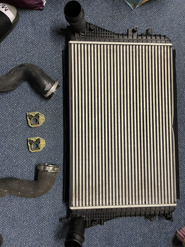

Firstly, I’ve purchased a used  Intercooler for my MK5 GTI 2006/07 BWA which has come from a S3 8P. Seller told me he was replacing his for an airtec Intercooler so I thought eh why not seems legitimate enough (maybe naively).
The part number for the Intercooler is 1k0145803be. Will this fit my car?

A question to you and the rest of the forum remains however. Will the Intercooler I have purchased fit as intended onto my MK5 GTI?
My MK5 is 06. The person who I bought it from had it removed from their S3 8P. I assume if the S3 was between the years 04 - 09 it would be a straight swap. Is it the same therefore for a S3 8P 09- or a MK6 GTI/R?

It will fit but you may require the pipe work from an S3, or modify the existing pipes.

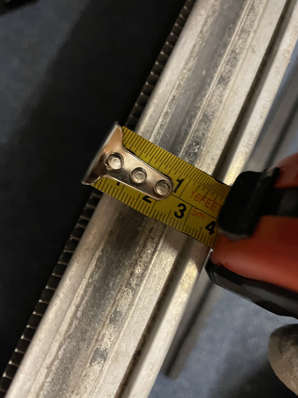

Just attached some pictures of the Intercooler I’ve bought and what it came with. The only thing I’m worried about is whether the Intercooler will provide the sufficient function for my engine. It looks like it measured as 40-42mm depth which  I think is what I need for when I go for more power.
I am admittedly a Noob in this field, just need to know if it will do what I need it to do  :happy2:

You shouldn’t have a problem fitting if you have the pipes so all good there. Does one of the pipes have a metal coupler in the end ?  The S3 cooler is a popular upgrade for mk5 golf’s as it’s thicker than the standard one on our car’s. Power wise it’s good for up to 350 ish bhp.
