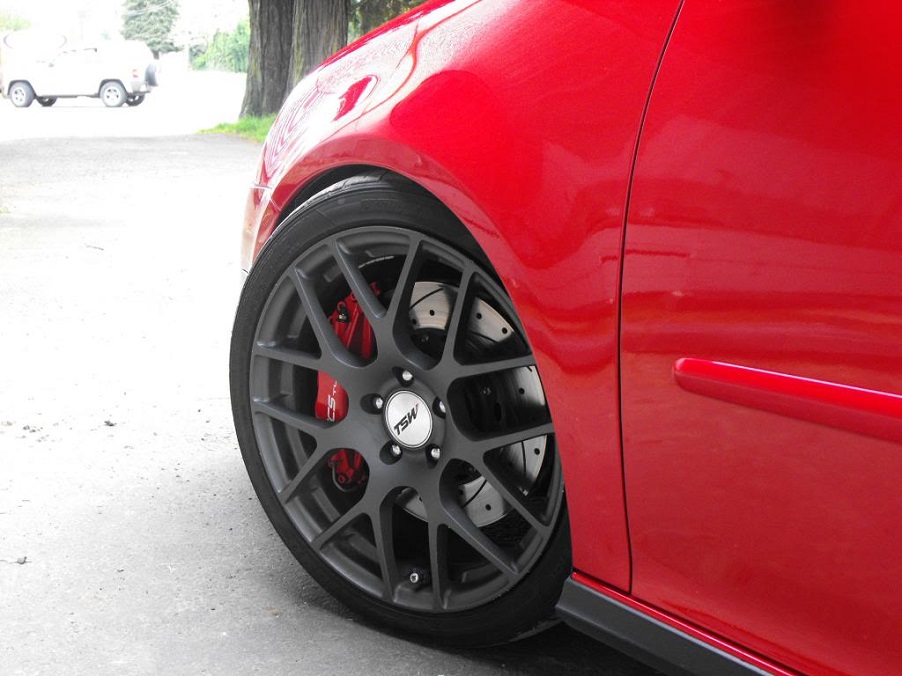

Apparently he just finished up...adding retention clips and bleeding them tightened it all up and he says they feel great...much better. I'm thinking he panicked a bit...and I had no clue having never dealt with the OE brakes. Other than to replace mine eleven years ago with these;
