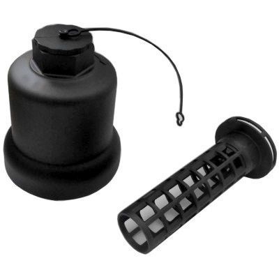

Changed that with a new housing like this one last night, went for a spin and kept an eye on it while the car was parked for the next couple of hours.. no drips everything looks good

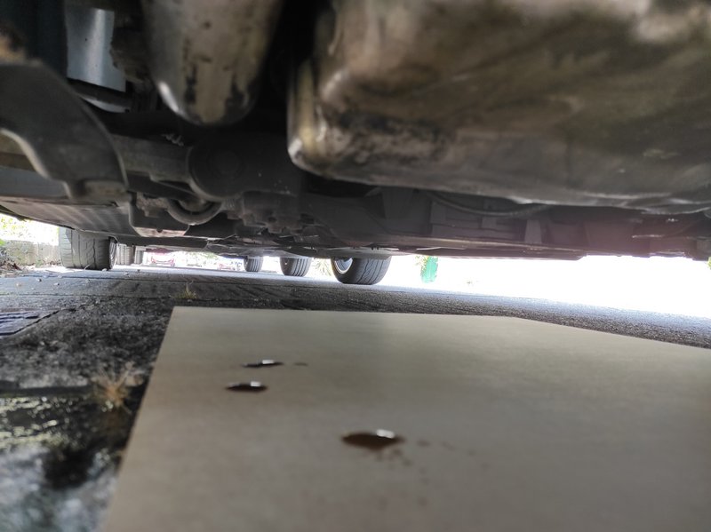

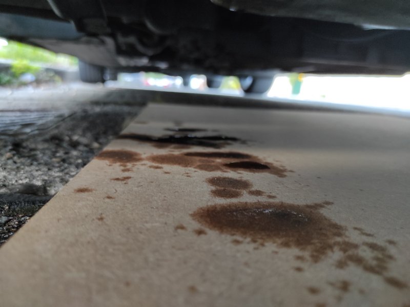

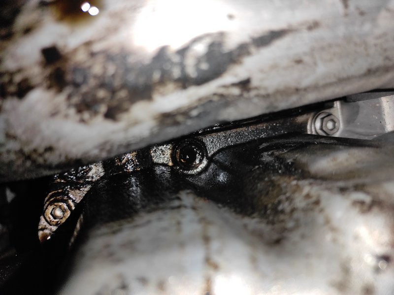

from the pics it looks like the leak start where the sump joins the block.
Is that what you see underneath the car?
I initially thought it might be oil that you'd spilt when filling the car but the oil looks like it been through the engine.
Is it still dripping?

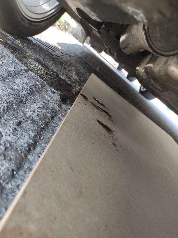

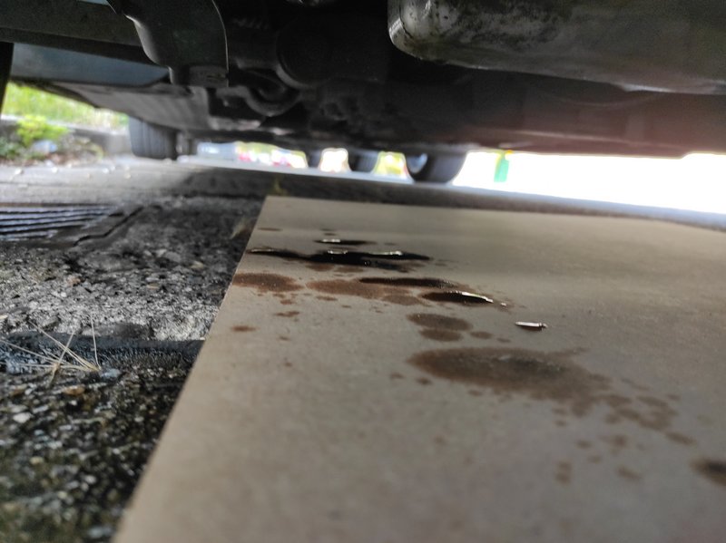

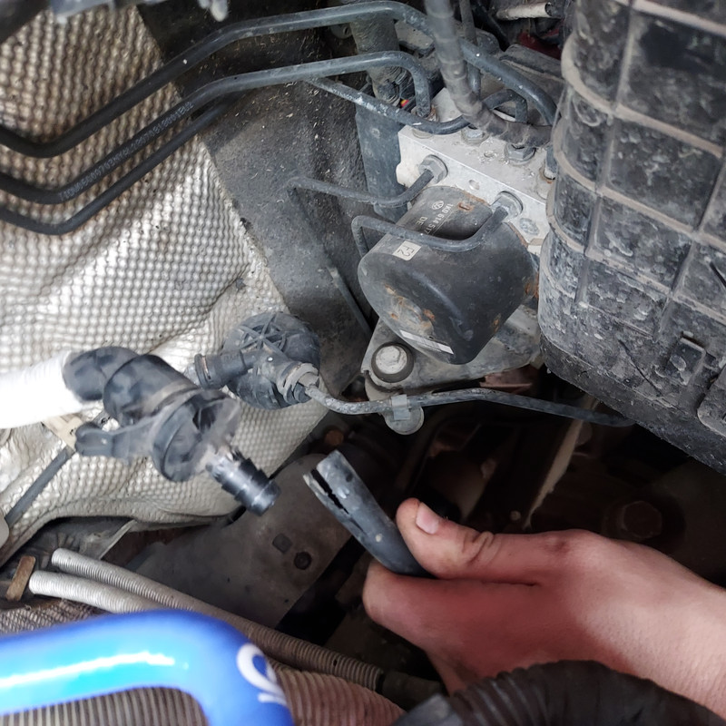

Yeah I didn't put it up on stands today to change the oil and filter housing, just done it on the ground as was in a bit of a rush.. so that's as far as I can get under for now. Hopefully will have time on Sunday to have a proprer look.
Seems to be still leaking, although not as much.
This one is from 6.10pm
This one is from just now
and upwards towards from where it seems to be coming from - so not sure if it's just old oil that's heating up and dripping when the ending is on... or a leak from sump or above...
Thanks!

That picture looking up at the block - that's been leaking there for a very long time.
Looks like its the gasket seal between the block and the oil filter/heat exchanger was weeping, changing the oil filter holder has disturbed it making it worse.

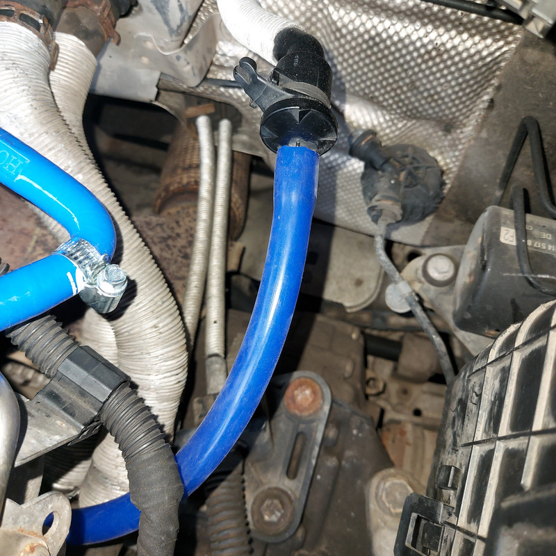

Hmmmm, those drips are nowhere near the oil filter housing.  It's all on the left side, which could either be a bad crank seal, bad cam cover gasket or a bad camshaft seal.
Worth also checking the turbo oil feed line in case that's leaking and wicking round to the side of the engine.
If oil can be seen dripping out from behind the cam belt cover, it's likely the crank or one one of the cam seals.
If it is the crank seal, that's the worst one but not that bad in parts. Around £20 for the seal with tool from Elring, £16 for the diamond washer and a fiver for the crank bolt. All are one time use.  The worst bit of the job is removing the crank bolt if you don't have a beefy impact wrench.

OK cool.  Just to confirm, the last pic is behind the metal boost pipe yeah? If so, unfortunately the crank seal could be a suspect.  Not common for that one to go on these engines to be honest, but not unheard of.  Hopefully it isn't that.
If you're lucky, oil from an easier seal to fix has crept round that to that side?  Are you 100% sure you didn't tip oil past the filler neck?
