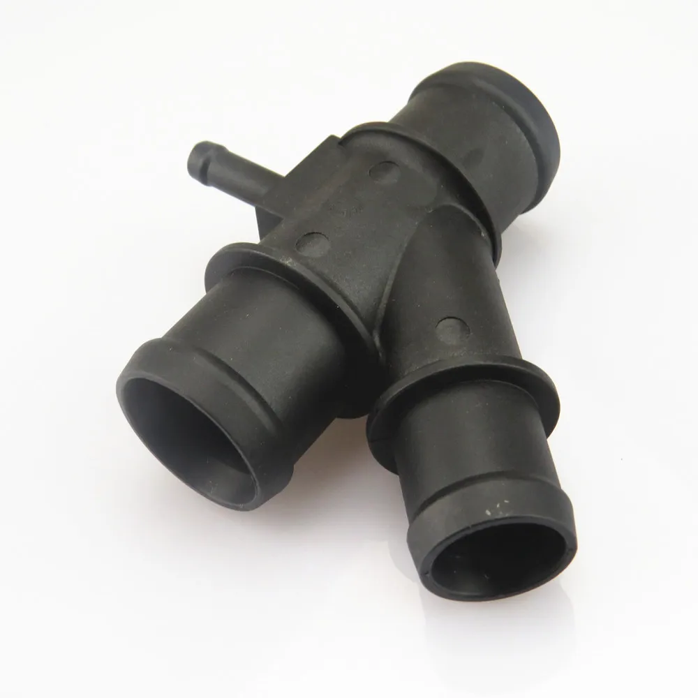

Yes - they do different tasks, but if I recall correctly its the one mounted in the thermostat that runs the fans - Mine had fans on all the time - changed the sensor over the gearbox - no change, had to take out the thermostat that I only fitted a few months before and the fans stopped randomly running.
Inline DSG thermostat is usually open, I can only assume to allow some flow rather than none.
Pretty easy to change, just be careful squeezing past of the pipe connector like this:
The small tube snaps really easily...dont ask how I know.
If your quick with your hands and get the pipes just nearly off you can change them without losing too much coolant.
