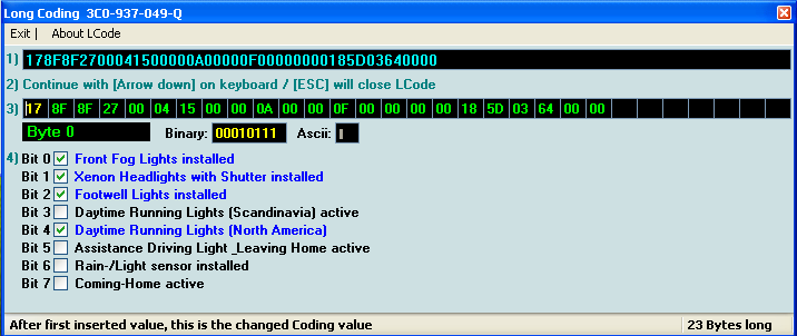

Got some genuine xenon headlights & adaptor looms for my 2005 Mk5 Gti, anyone know what codes I need to change for them to work. (Car has standard headlights).

Assuming you didn't install the range controller and level sensors? Then:Central Electrics->Byte 0, Bit 1 checked.

No, didn't do range controller or level sensor,
Thanks for that info.
