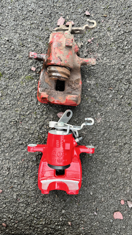

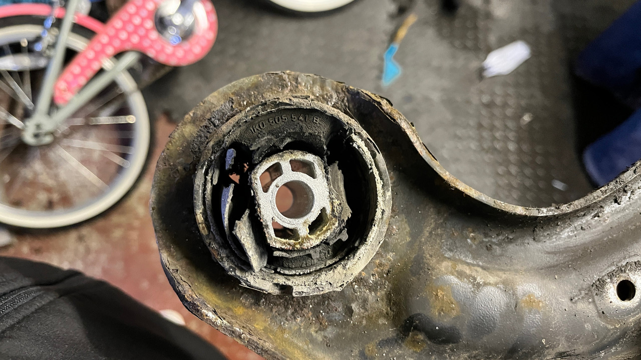

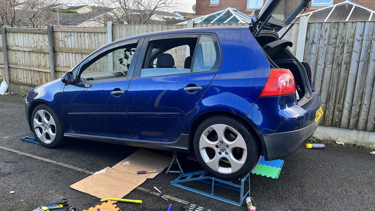

Well, yesterday was supposed to be rear trailing arms, a new caliper, new rear discs and pads, a service, and multiple mods, but oh BOY did the car fight!
it's apparent that the car has been parked over a wet surface such as grass that has corroded the rear far more than the front of the underside of the car. Ive seen this before on a fiesta I owned where the owners parked on grass and with the underneath in constant contact it had corroded significantly.

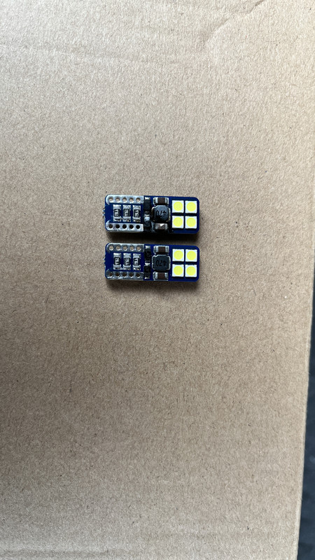

so, first things first, I added new LED sidelights from eBay yesterday. today, I turned up at my cousin's house on the drive and noticed smoke coming from the front of the car!! opening the bonnet, smoke poured from the front right light and noticed it was the sidelight bulb!
Thankfully we caught it in time - i can't imagine an electrical fire would be the best thing to have on a car!
So we cracked on, removing the rear caliper first and the pads basically disintegrated away when we removed the assembly. the caliper was definitely binding, to the point the disc had turned blue.
Unfortunately just after this we tried applying the brake pipe to the new caliper and realised the threading in the new caliper was completely cross threaded and unusable! At this point I was ready to have a small panic as the caliper was £125, with no access to another, and with a completely borked old caliper 50 miles away from home.
Many hours later and by torchlight, we managed to fabricate our own brake pipe and clear the old caliper of rust and other build up, temporarily at least freeing up the caliper!
This process took around 3-4 hours, so by this time we are talking around 5pm and the car had been fighting the entire time - bolts seized, things not coming apart that should, etc. We had to now change the rear trailing arms and oh boy - 3 hours later we had them changed, but again not without the wind, rain, hail and the car all against us! They DEFINITELY needed doing though - here is one example of the absolutely shredded bush I had:
Thanks to the top work of my cousin, 12.40pm turned into 8.20pm but more importantly the rear brake and 2 trailing arms that were definitely going to fail the MOT were changed. We didnt get around to all the mods I brought with me (DV+, Cat back exhaust, anti lift kit being a few) but most important things were done.

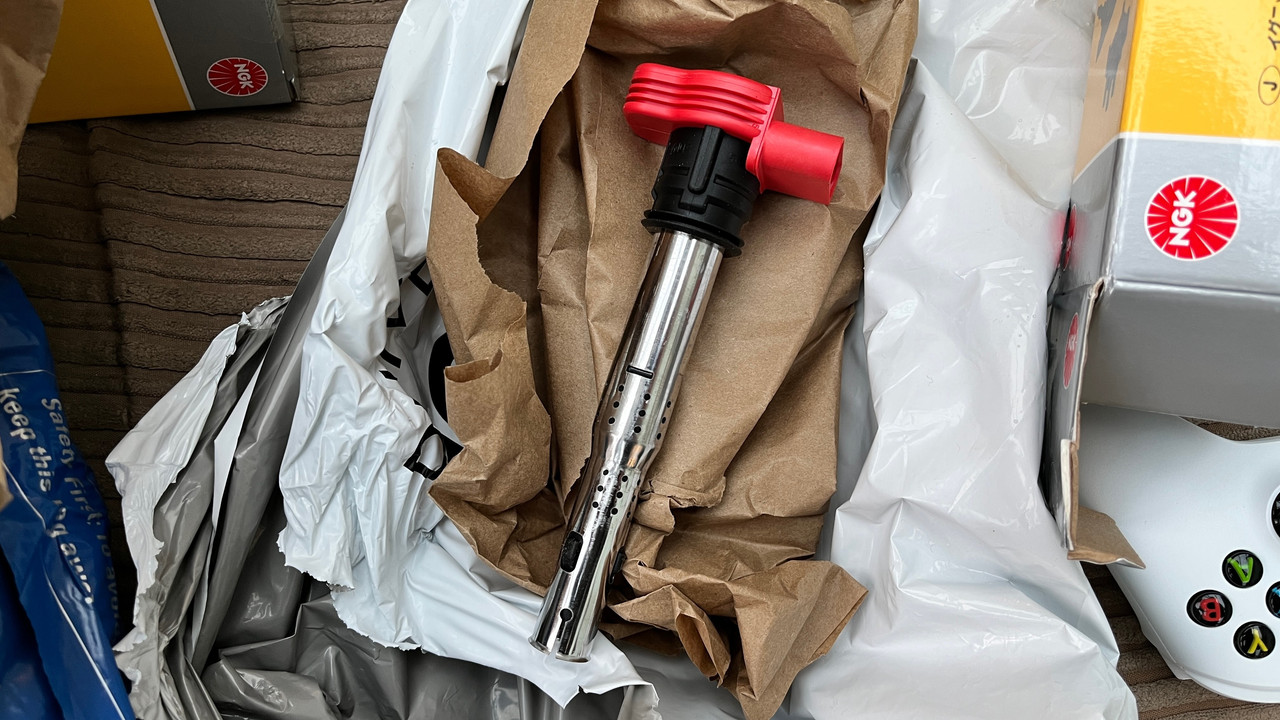

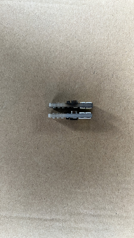

R8 coil packs arrived  :party:

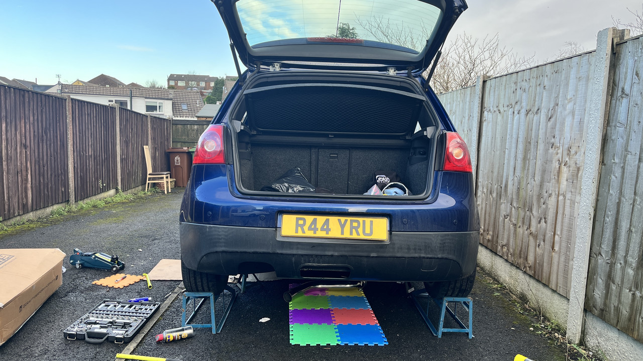

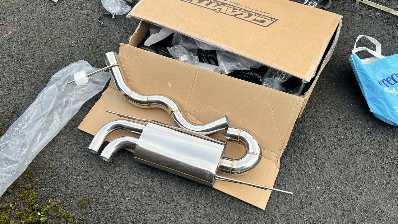

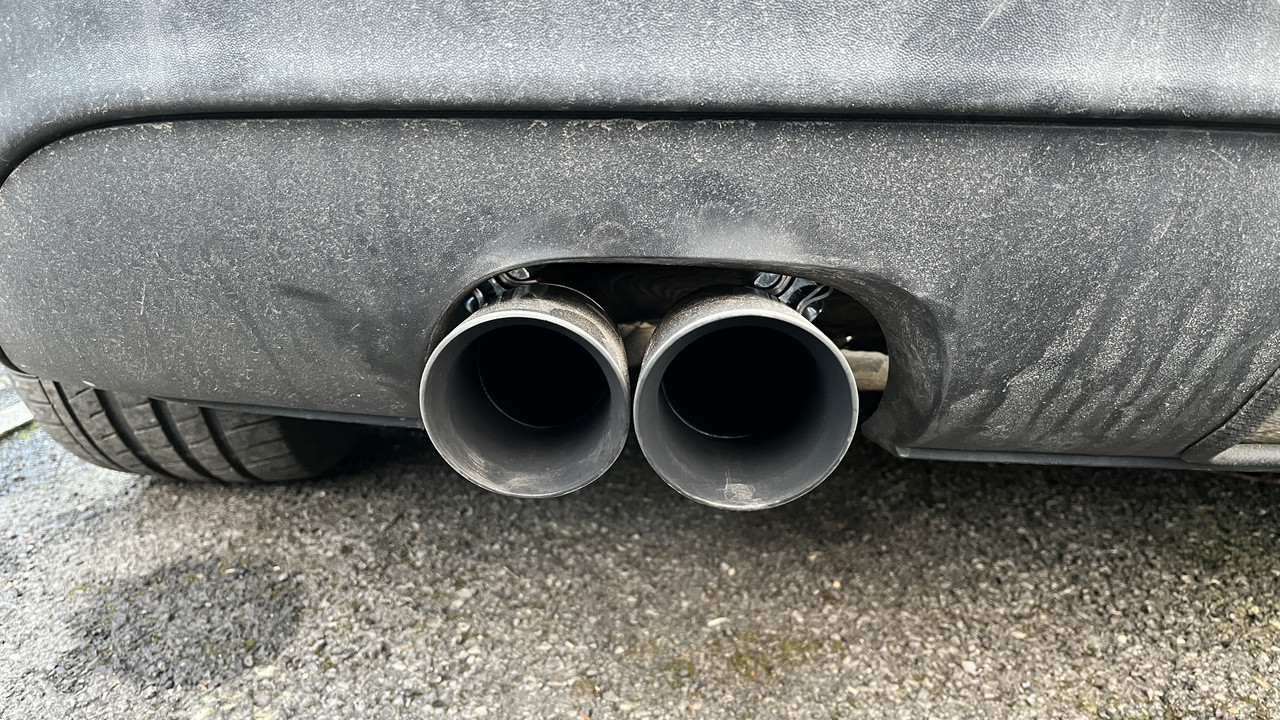

I attempted to fit my new cat back exhaust to my car - unfortunately i never realised just how much my driveway has an arch, therefore the clearance when jacking up the car in the centre is minimal :( looks like ill have to wait!

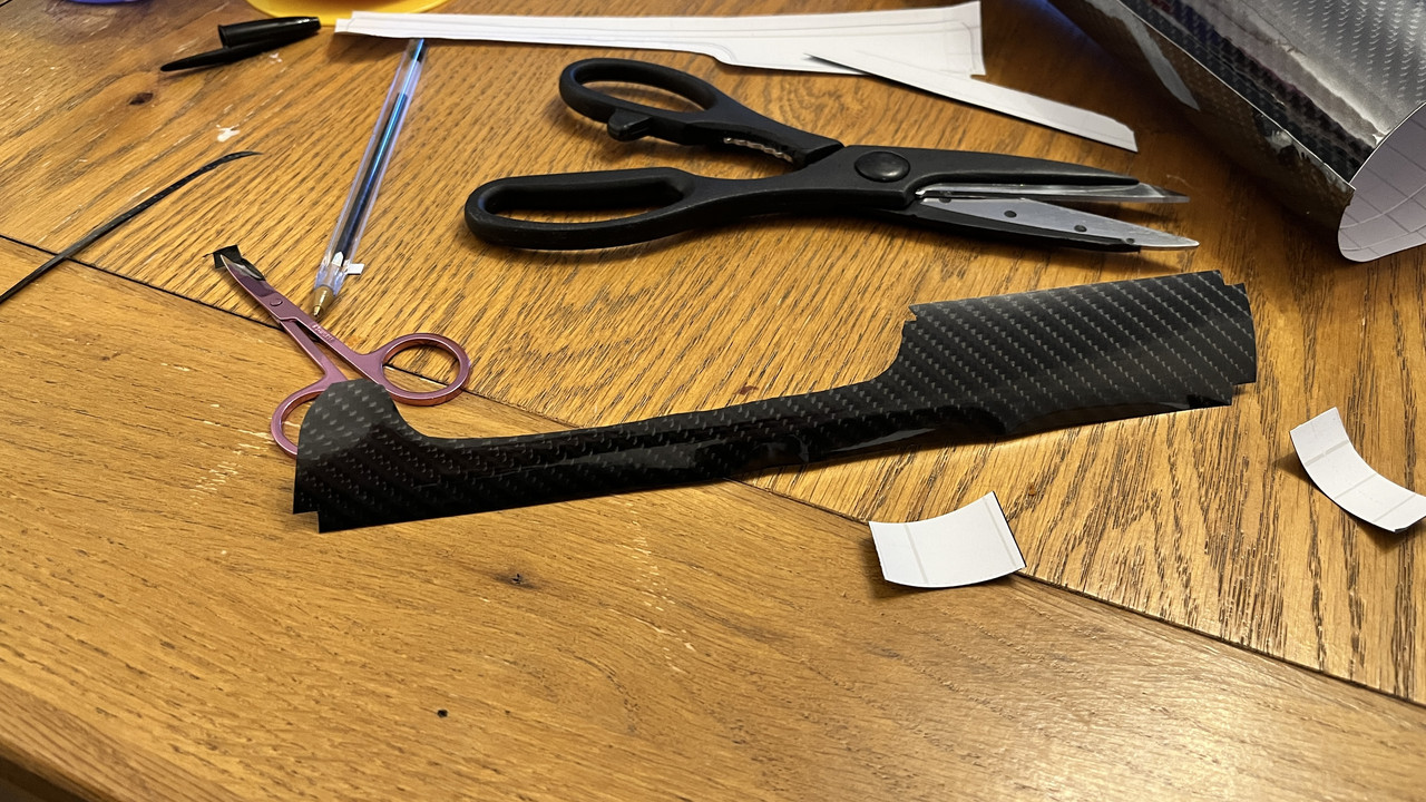

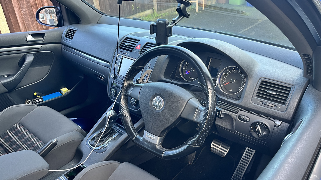

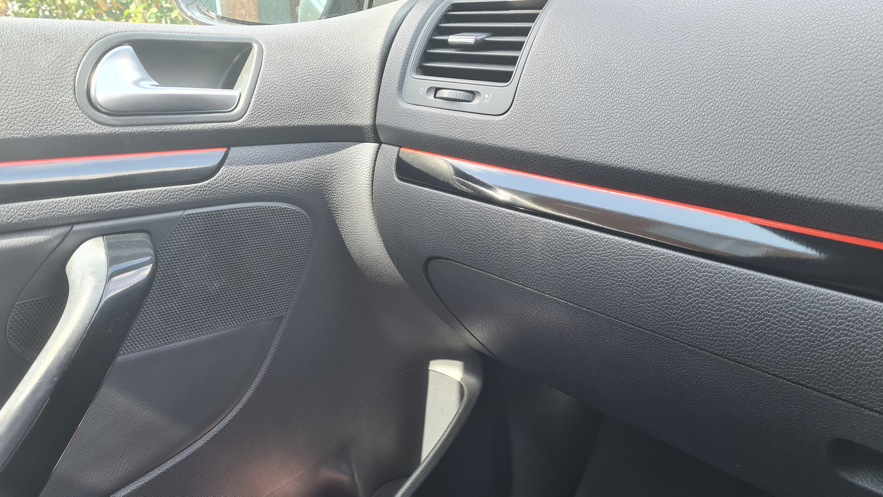

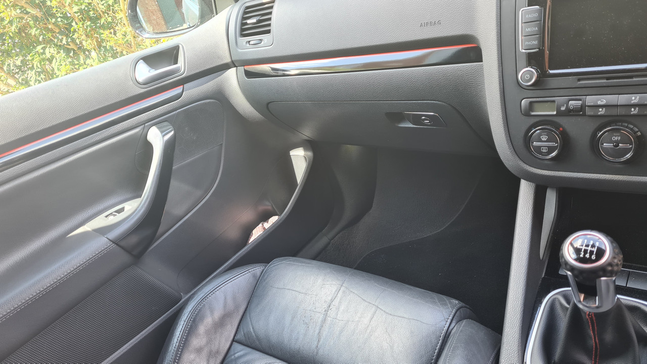

I am on with wrapping interior parts with cf gloss wrap. Originally had them matte but they blended in too well.... if thats possible. Wanted something that popped a little more in the interior. Tricky business and time consuming but I think the end product (along with a few other goodies) will set off the aged interior well.

Getting heat into the wrap is the secret.
I gloss blacked mine with a red pin stripe to carry the GTI theme.....as well as the grab handles
Mike
South Coast
That looks fantastic buddy, did you do that yourself? It takes a lot of patience thats for sure! Although the finish on mine isn't going to be perfect, i'm glad i've given this a go myself.
Now to figure out how the hell to get the dsg surround out!  :grin:

Yes did it myself......time, patience and a decent hairdryer (don't tell the wife)
Once you get it evenly hot, it will stretch nicely.

Well, the finish (although not perfect) was actually much better with a hairdryer than without :grin:
Next i think i need to figure out a black interior haha

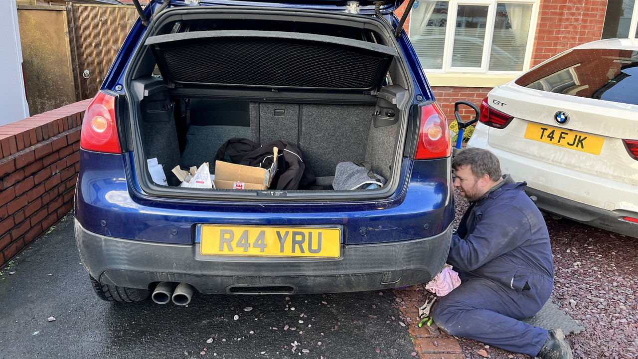

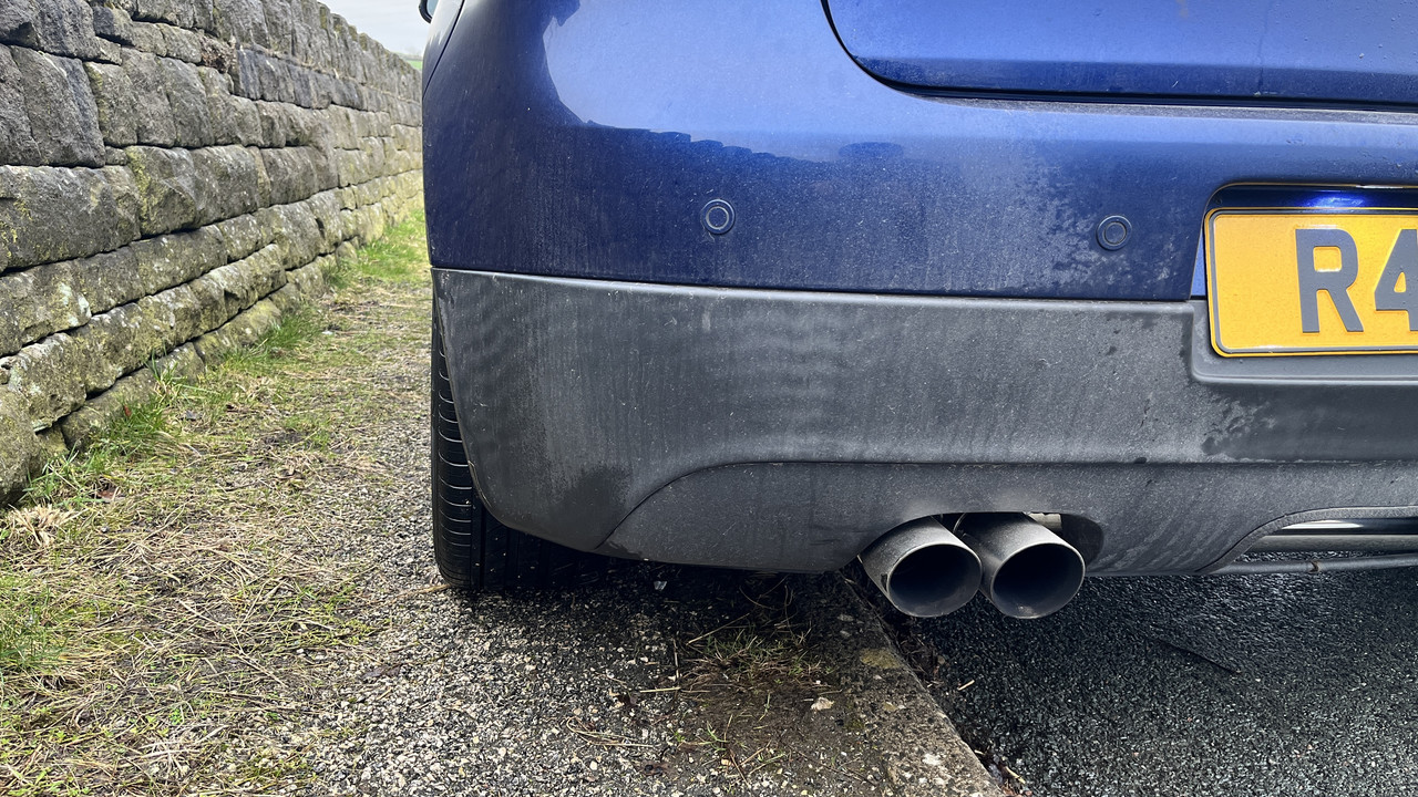

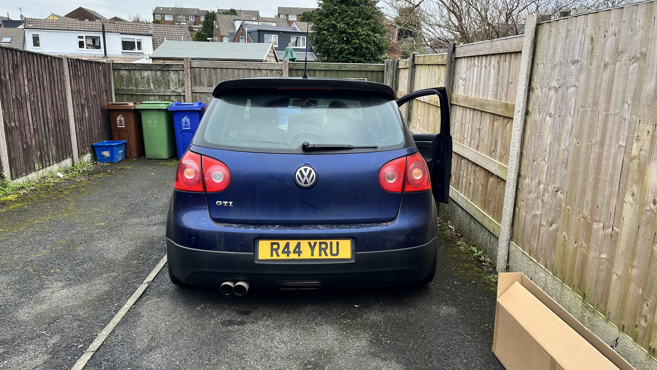

Today I decided to fit the cat back exhaust prior to the MOT due tomorrow morning. Although the fitment wasn't perfect (We have blowing from several clamps - sigh), it actually sounds pretty darn good.
I dont have any after pictures right now, purely because everything was purely for testing after fitment and ive got to have the garage sort the alignment, but here are some in-progress pics:

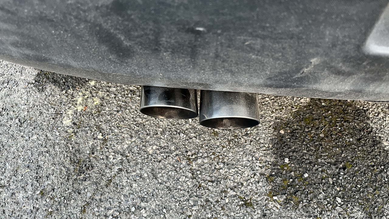

So when I last left off we were fitting the cat back exhaust ready for the MOT. Although I would recommend the Gravity Performance exhaust based on the quality of the components individually, placing them together without a ramp was an absolute pain in the a*s. Instead of the straight swap from standard to new, it took a couple hours longer to get everything aligned, but also to sort any blowing that was occurring due to an imperfect exhaust system. Alignment of the tips was also an issue, both in the fact that they both went over to the left side of the vehicle (the hangars dont have stoppers so they free roam) but also that the tips point in toward each other when the clamps are fully tightened. Ive since had this sorted by use of........... DIY solutions lol.

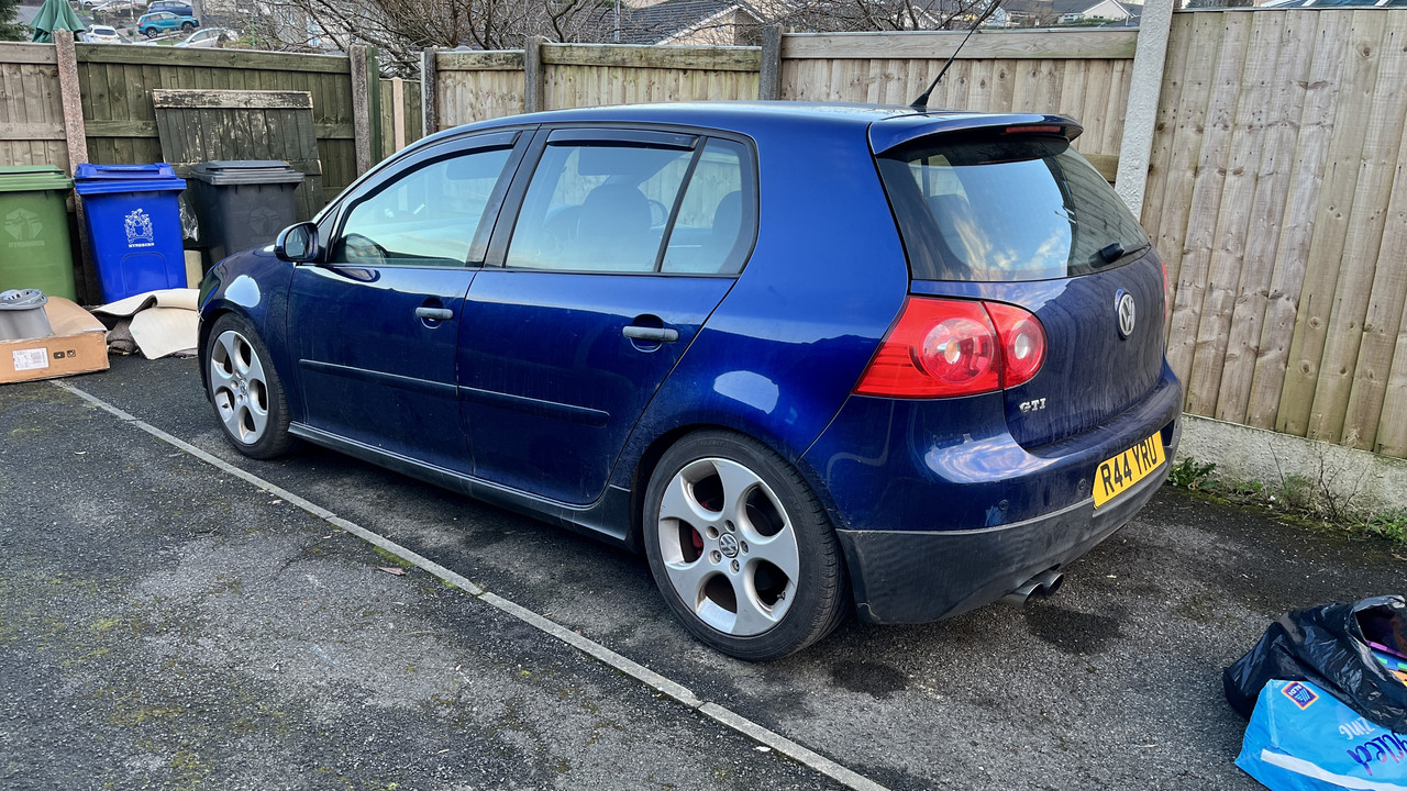

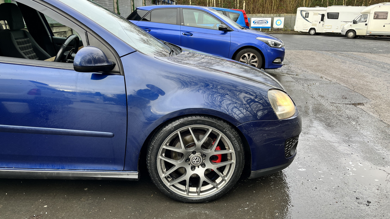

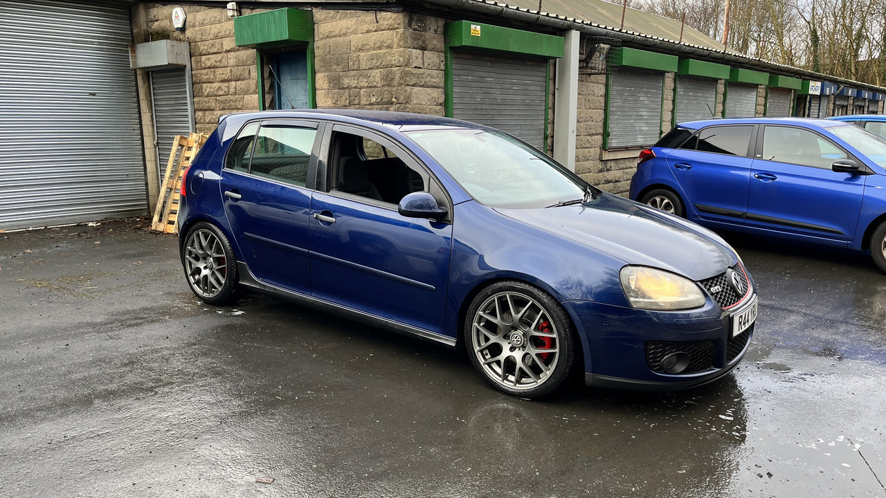

The lowered suspension was exactly what I wanted - a lowered car but retaining the ride of the golf, without becoming too crashy or wallowy. granted, i do have to avoid more potholes and steep slopes (My daughters nursery happens to be on the worst gradient ever) but I love the stance.

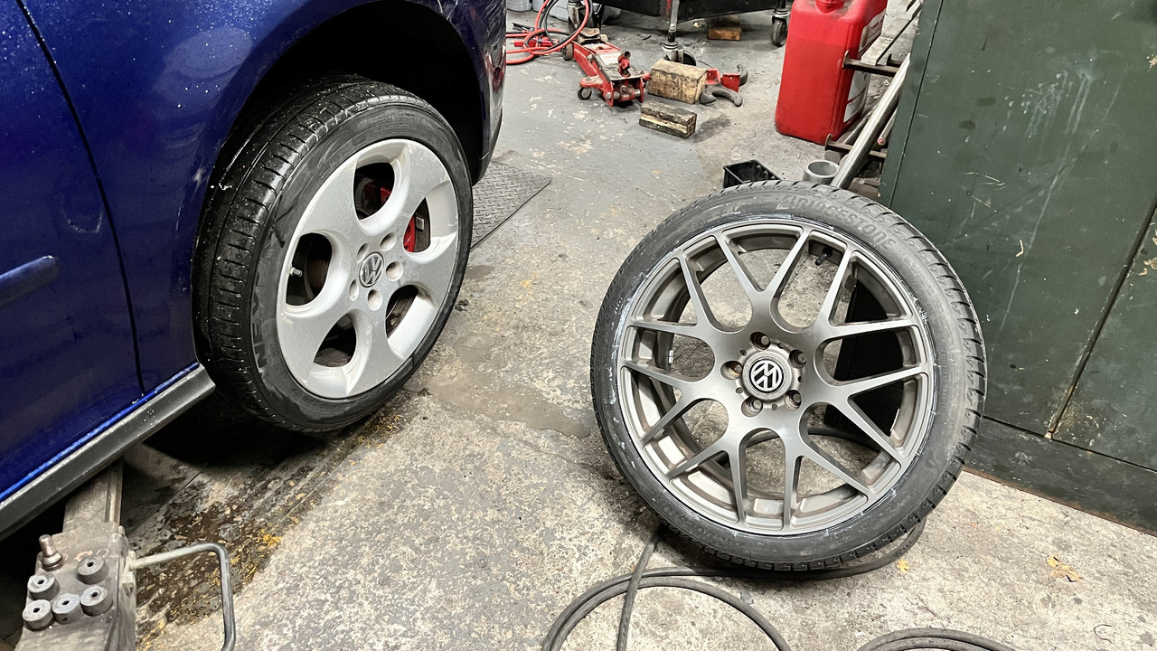

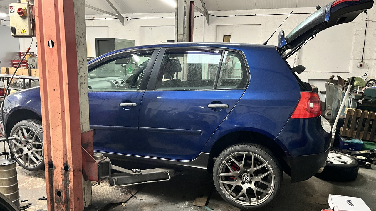

So it was at this point my cousin texts me mentioning that his partner has a set of alloy wheels for sale. I have a slow puncture and will need a tyre either way, but the temptation to go aftermarket wheels was far too great. I purchased the wheels and got new tyres placed on (Bridgestone Turanza's) and I purchased a set of spacers.
When fitting the wheels, two things were realised. One, we needed spiggot rings as the hub diamater was 57.1mm instead of the 73.1mm accepted by the wheels. Two, the wheel spacers I just spent £160 on with extended bolts would no longer fit - FUUUUUUU!!!
Well, when we fitted the wheels with the spiggot rings, we realised they naturally sit 9mm further out than stock, and therefore I didnt even need the spacers. Win! Im so pleased with the wheels, they set off the FFB (Fun Family Bus) so well.

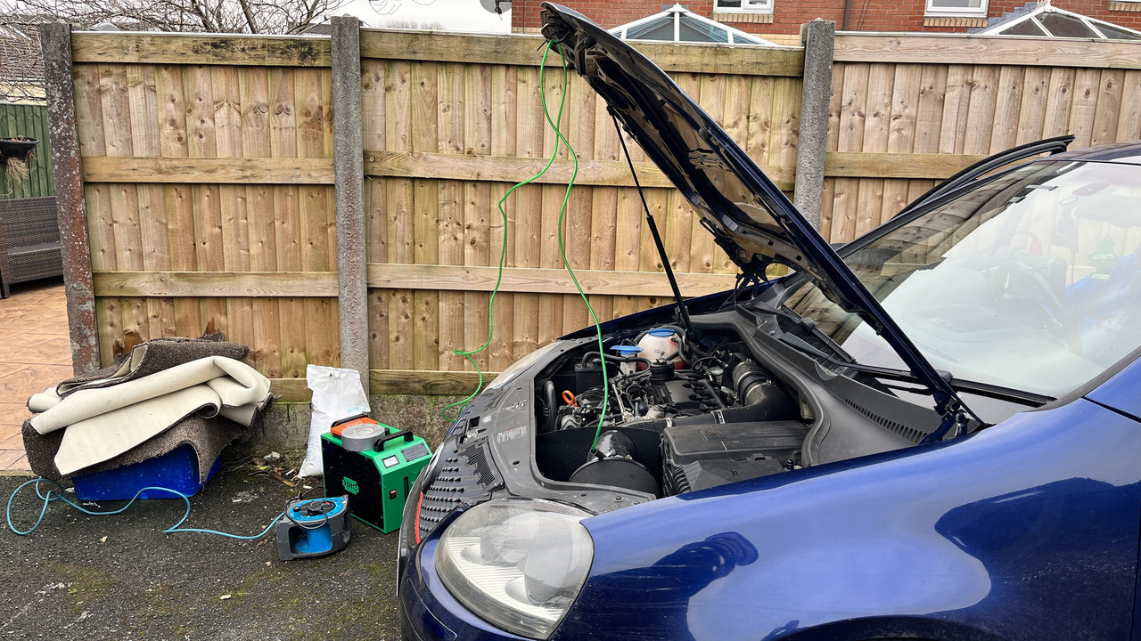

Since the fitment of the wheels, I had a chap round to do a carbon clean of the engine. Apparently this cleans out deposits in the intake and helps fuel economy and performance. Whilst at it, he did offer to put a stage 1 map on, and for the price I couldn't argue, but it appears it may have done more harm than good.
During shifts above 3.8/4k, being a DSG this was pretty much instant and the power delivery continued through, but there is a 0.5/1 second delay where it hesitates and goes "should I go full throttle? yes I should" then carries on. Bearing in mind my foot is fully down the entire time and the paddle is flicked, this sudden hesitation is unsettling. Thankfully, the chap is coming to revert the map, as I believe it is an issue with the map and not the car.

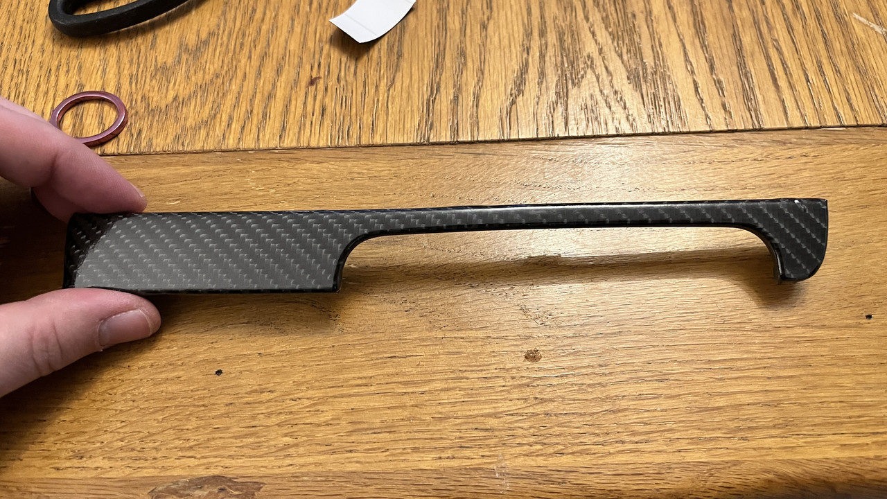

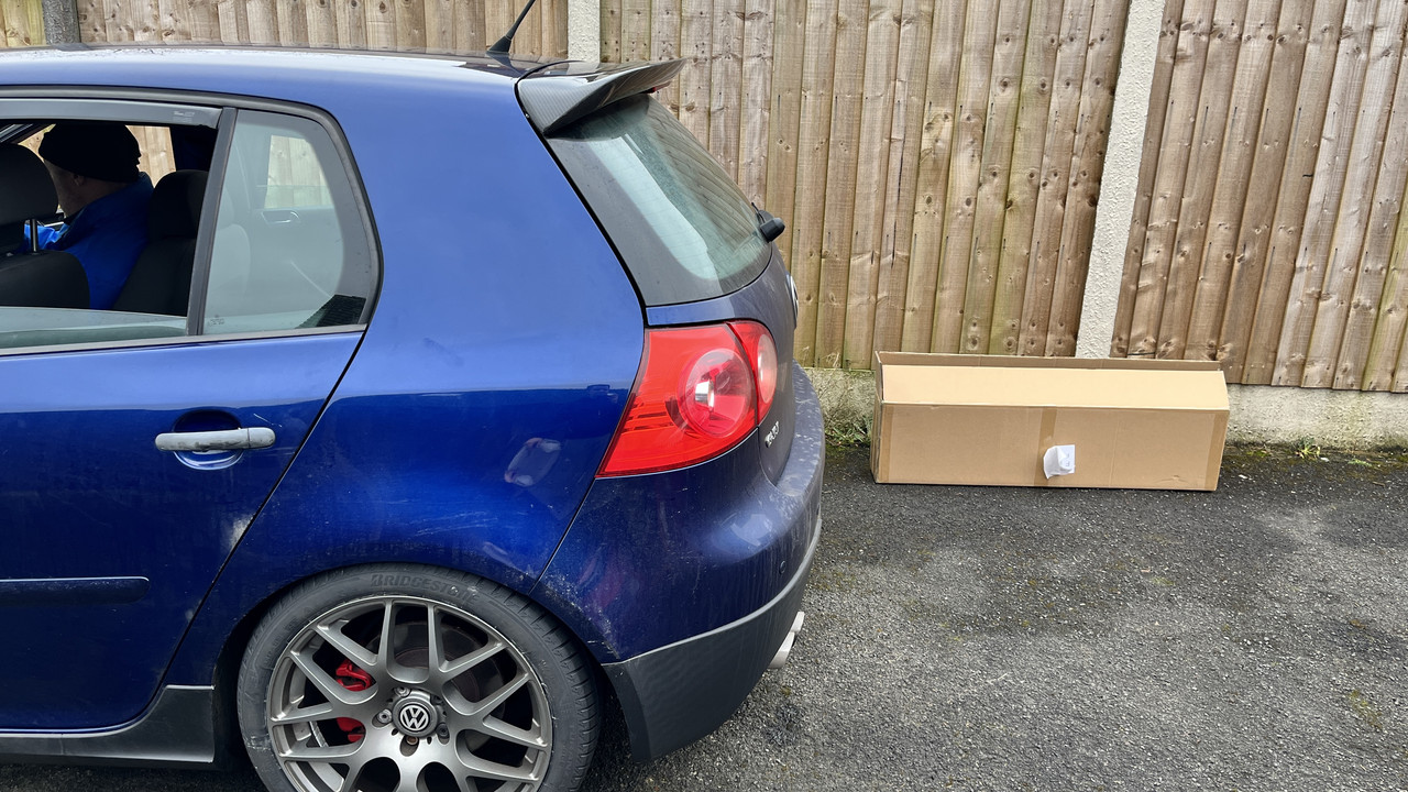

So we arrive to today, where I have a huge amount of parts to fit to the car which I won't list here to spoil the fun, but here is a quick fit of the carbon fiber rear spoiler to compliment the mirrors and door inserts I have coming  :party:
Car without the spoiler for the time being - everything will be fit at the same time :)
