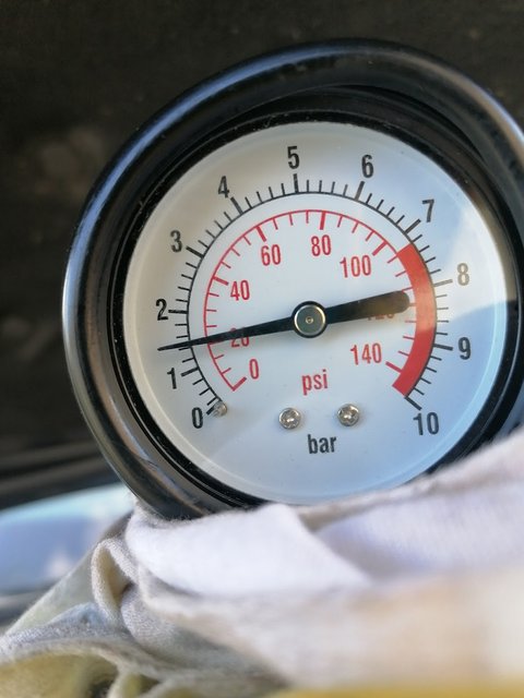

The oil pressure gauge is a bit strange. The pressure only goes up, never down by itself. To get and accurate reading you have to press the relief valve at the bottom of the gauge, which squirts out a little oil but 'updates' the oil pressure reading. I am not sure if this the intended behaviour, as it didn't come with any instructions nor could I find any on the web.
60psi on cold idle. This gradually goes down to 20psi as the engine warms up.
When revving while hot, it increases to 60psi, or 80psi if revved even higher than that.
But measuring it after revving it, it drops to 19psi.

EDIT: I've just realised from looking at a picture of my oil pressure gauge that I've been misreading it. Between 0-20 psi there are 2 separating thin red bars, whereas between 20-40 psi and above there are 3 separating bars. Meaning instead of me calculating 17.5 psi, it was actually 16.6 psi on hot idle, definitely below minimum. Now it makes sense that the previous owner added an oil additive to mask the issue. I'm going to drop the pump as soon as I have time and investigate, hopefully I find a problem with the pump otherwise it's time for a replacement engine  :scared:

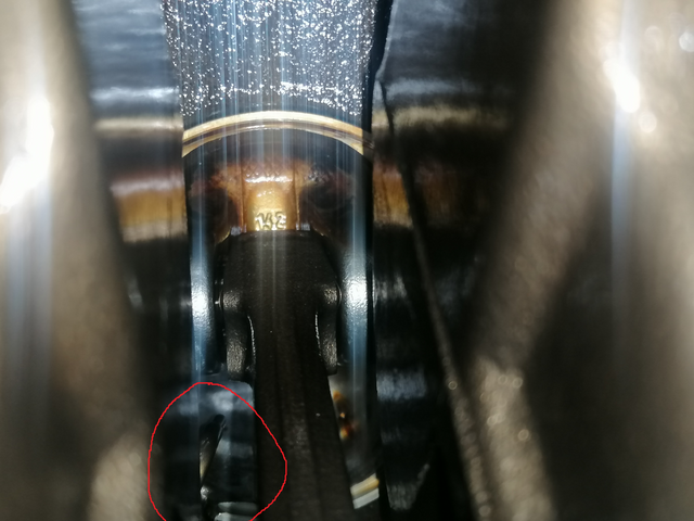

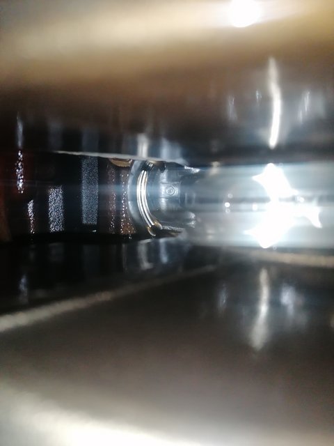

Well, I was really hoping I'd find a problem with the oil pump, but when I took off it was perfect, both shafts rotated very smoothly.
But what was unfortunate was what I found above the oil pump (
).  :sad1:

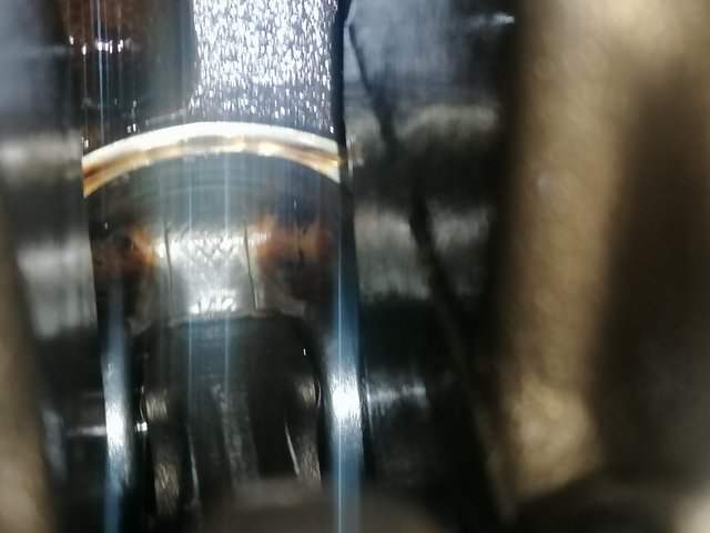

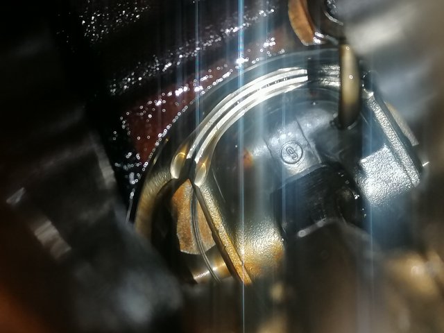

In addition to that, here is what the underside of each piston looked like:
Piston 1:
Piston 2:
Piston 3:
Piston 4:
Piston 2 looks very burnt, as also evident from rocker cover on camshaft where the cam shaft looks burnt above piston 2.
Since the oil pump seemed perfect, is it time to start looking for a new (used) engine? Or is there any chance this one can still be saved? The blue scorch marks and wiggle in the rod ends make me think it's pretty terminal.

Looks fine - the discoloured area on the cam is the oil fill location.

I'm not seeing a whole lot wrong there.  Con rods are supposed to have horizontal play (but not vertical play!) and the clean areas on the pistons just look like where the oil squirter were doing their job?
The dark staining is typical of engines on long life servicing, but not necessarily a sign of terminal damage.
Was the 140psi compression reading on a hot or cold engine, and was the throttle wide open?  The spec for a new engine is around 14 bar (200psi), so yours is way down if the test was done hot at WOT.  140 isn't too bad though.  You only notice reduced compression at idle and part throttle.
I don't think you're at the new engine stage just yet.
