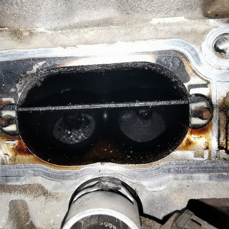

 A maintenance has been made to correct the known issues of the EA113 engine. You can see that the cam follower was in bad shape.
During the maintenance in the workshop, the guys saw the intake duct was fullfilled of calamine. So i told them to clean that. It was handmade.

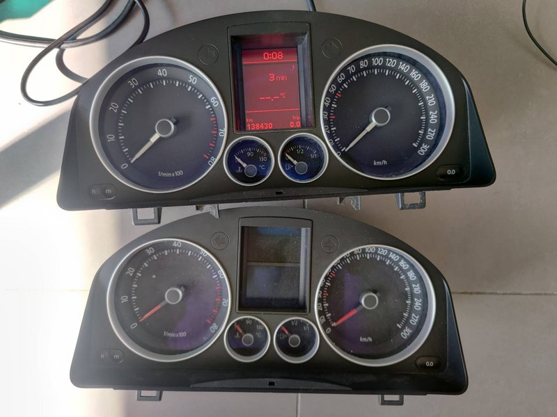

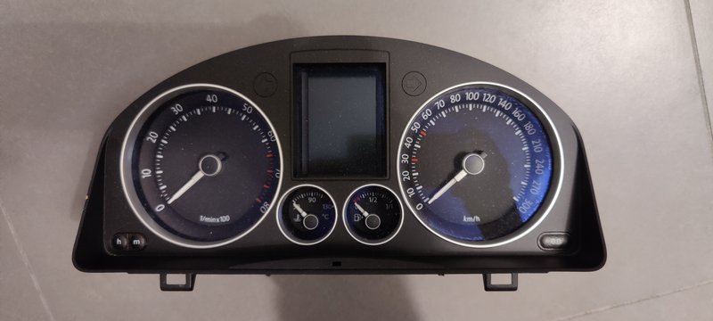

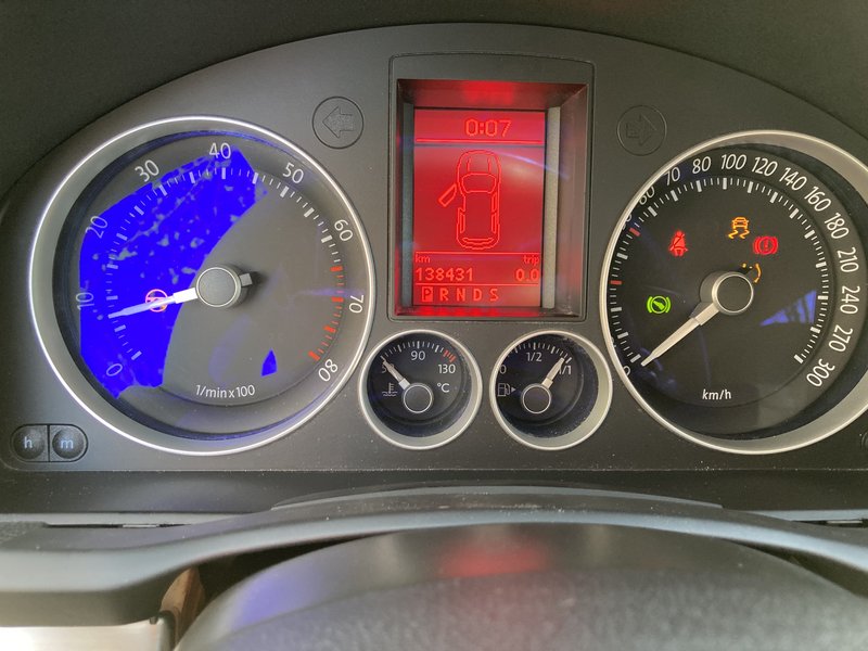

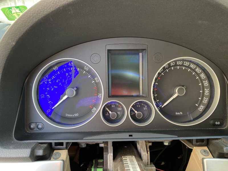

I was searching for a MFA+ to have big screen and have more options on the car. I found this! A R32 cluster
The guy who sold me the cluster did all the work for me, i.e coding the option of the stock cluster in the new one, put the right mileage, VIN and so on.
Fitted in the car

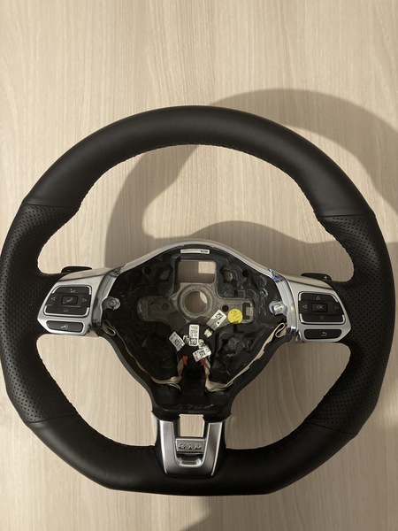

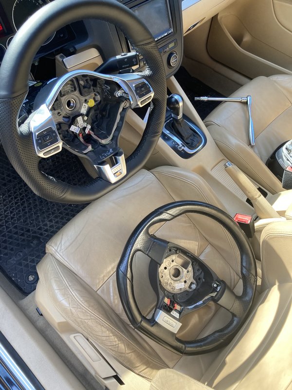

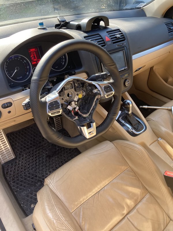

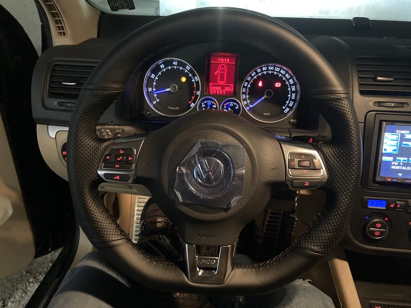

With the R32 cluster, it's time to refresh the cockpit. The next target is the steering wheel. My idea is to have a replica of MK6 R Steering wheel. The steering wheel are very expensive on the market and very rare. So, i decided to buy a classic one with DSG paddles and flat bottom and put the necessary parts to have a replica R. i found this one and i took it.
The guy who sold me the steering wheel was about to mount his MK6 in GTD style but he said me he had a massive penalty to not have respect lockdown, so he decided to sell the steering wheel.
The same guy who installed cruise control for me sold me the airbag and fitted for me.
MK6 vs MK5
Fresh interior with MFSW MK6 and R32 cluster

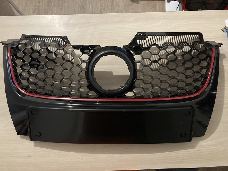

A brand new front grill because the stock one lost his colour. The grill became grey

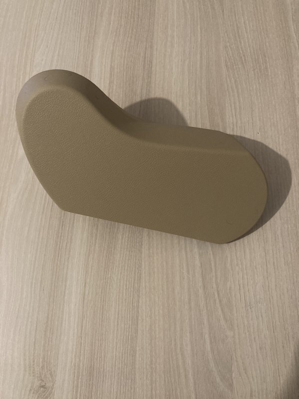

It's a plastic part which fitted on the side of driver seat. It's a part i bought in order to swap the driver seat with a fully electric one. Sadly, i ordered the wrong side. That part on the picture is for the passenger seat.

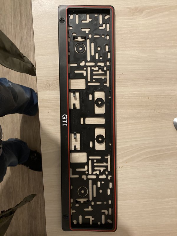

An oldschool ID plate support

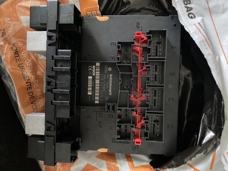

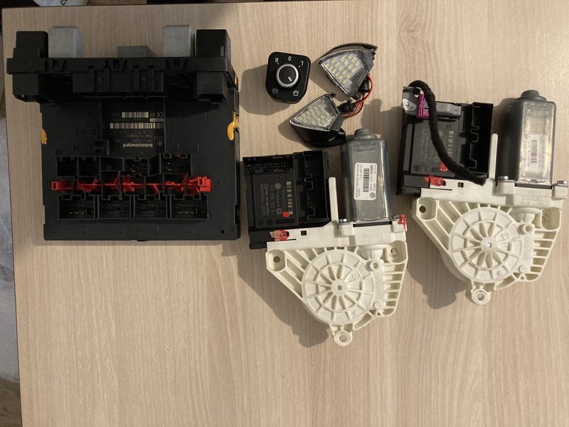

Some stuff to improve the car. a highline CECM from Passat CC. New module door to implement electrical folding mirrors. New switch for the mirrors and mirror led light.

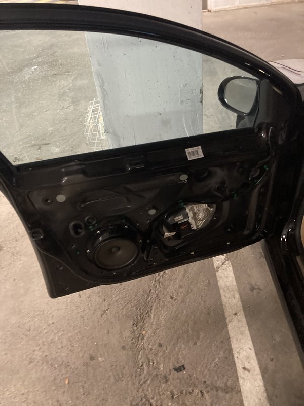

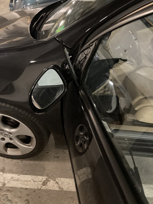

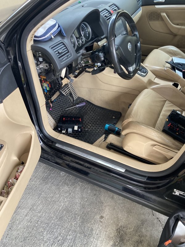

Some work were made on the car. I removed the stock mirror to put electrical folding mirrors. I have to change the door unit also.
A guy installed the new CECM highline for me.

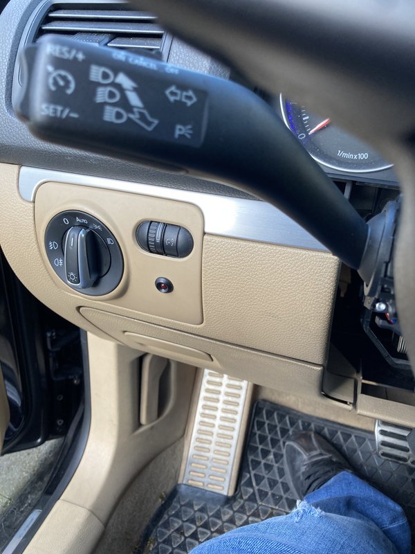

I have some troubles with the new CECM. Before the installation, i had no problem with my  windshield washer, everything was ok. i have a brandnew washer pump.
Since the new CECM, when i press the commodo, wipers move but there is no liquid sprayed on the windshield.
Washer headlight for xenon work and sprayed the liquid on the headlight.
On the rear side, when i push the commodo on the first step, the liquid sprayed out continually and doesn't stop until i push the commodo to the zero step.
If i push the rear commodo  to the maximum, there is no liquid sprayed.
I put new relay on the CECM but the issue persists. I changed the 449 relay in position DWP-V position and KL30 position.
I changed the fuses related to washer system.

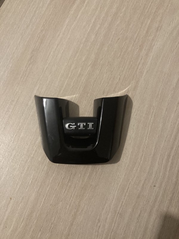

I ordred a black GTI trim for the steering wheel. I am waiting to find the black multifunction button to mount them together.

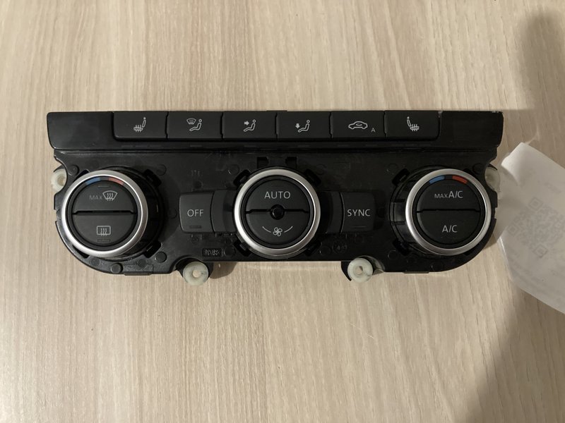

In order to have a highline setup, i ordered a highline convenience module 19 bytes
To refresh the cockpit, i had in mind to put a MK6 climatronic but i think the Passat/Scirocco 7Gen is better. So i took a climatronic from a Jetta. It will match better with the Disocver Media PQ.I will have to find a way for the fascia.

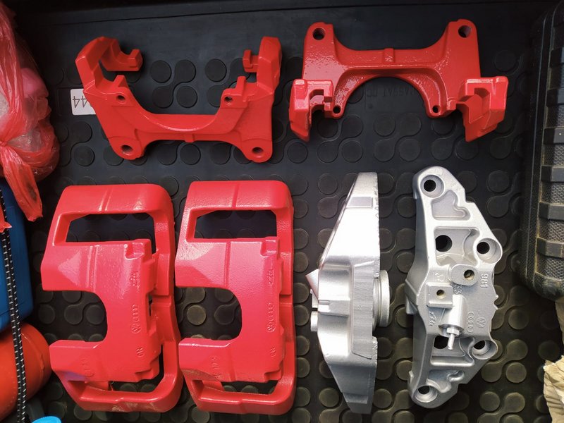

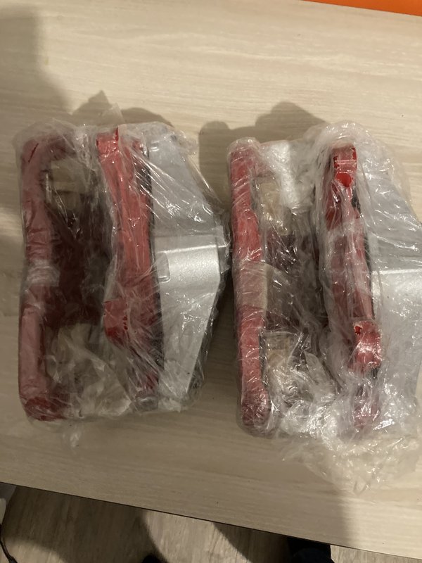

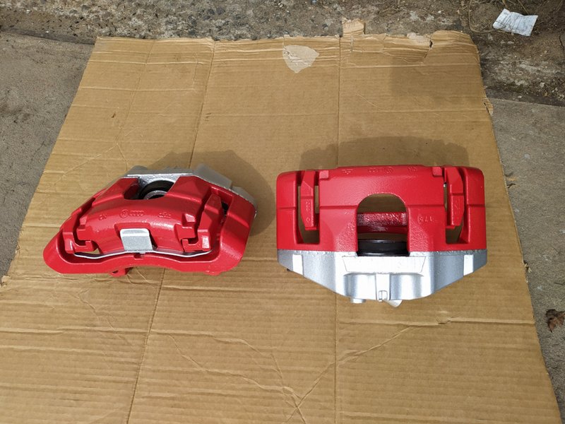

This is what is hidden in the parcel in the last picture in my last post : R32 calipers
I bought them to a guy in Belarus. He painted them for me in these colours. I will make a refresh of all parts, i.e, seals, pistons, guide bushing and so on.
I  have to buy rotors, pads, and pipes.

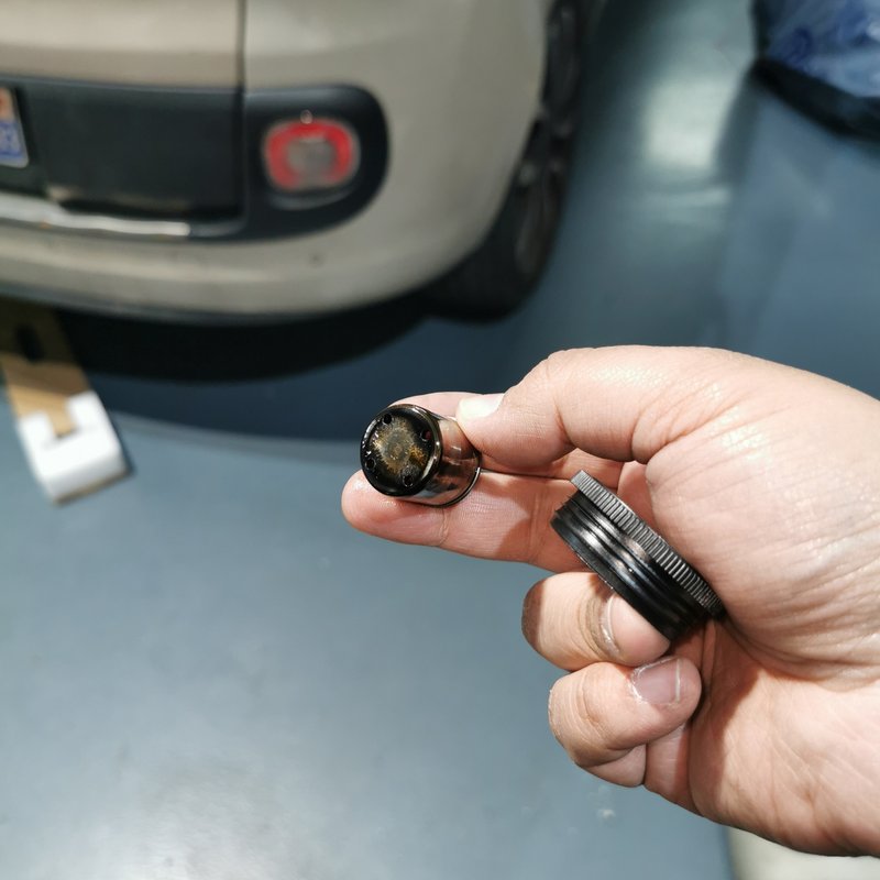

I put to the car to the garage for a service :
-Oil change
-Oil pump modification
-Oil filter change
-Rear bearing change, they were dead. The front will be change later, they received the wrong part number.
