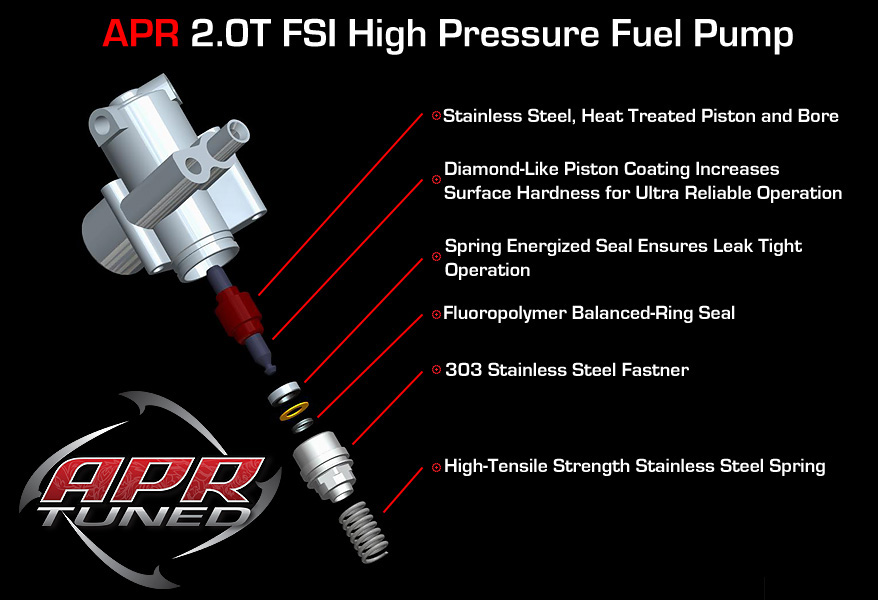

The HPFP does make a tapping noise.......nothing horrendous but rhythmic
Only pic I can find
The spring slides over the shaft and the the cap holds it on

Thank you for taking the time to put that up, unfortunately it's the other end I want, where the fuel pipes attach and the pressure test point is.
I think I have it right, I'm getting 50bar at idle on VCDS which scrolling through the forums looks about the right pressure, plus I suspect that it would flag up low pressure if it was all wrong, or high pressure.
Good to know about the tappety noise, it was probably there before but after messing up I was listening harder  :sad1:
