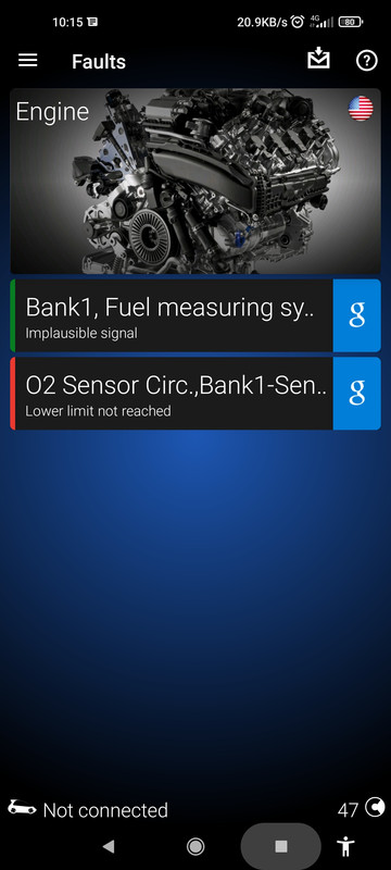

Offline briank213
  • Posts: 21
Re: Reflective silver Mk5 gti
« Reply #5 on: November 09, 2021, 08:52:06 am »
This is the fault codes I had on my car after tuning
Offline NorthWest
  • Posts: 22
  • 2007 GTI
« Reply #6 on: November 09, 2021, 06:45:57 pm »
no break up or stalling mate. cars driving 100%. i'll grab a picture of the dyno print out and post it see what ye guys think .
im using Carly obd scanner. fault is relating to 02 sensor .
P0030 is the code I'm getting. I don't think its a faulty 02, I think its just cos of the reading its getting and cats removed. I ordered a 02 spacer this morning so ill throw that on when it arrives and see if it makes a difference .

Offline briank213
  • Posts: 21
« Reply #7 on: November 10, 2021, 04:24:42 pm »
From the rosstech says its a faulty heating element on the O2 sensor because you changed the downpipe just double check that you O2 sensors are plugged in properly and check if there's no damaged wires with the heat these wires get damaged if you get the adaptor just make sure you put after the catalytic converter. Hows the Mk5 after the tune I had my car 6 years with no mods now my car feels completely different there's power all over the rev range. I also managed to race a golf 6R dsg on a rolling start and managed a 3 car gap over 1/4 mile and my car is manual.
