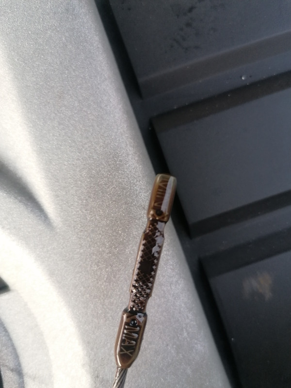

Done just over 200 miles now without any problems bar the random CEL that popped up at 40 miles, and have measured the oil at 10 miles and at 190 miles on the trip meter (nearly 300km between measurements).
Here's the photo at 10 miles:
Here's the photo at 190 miles:
I can't guarantee the accuracy since this on a slightly sloped parking space, but both measurements were done with the same car orientation and on a completely cold engine.
By visually guessing I'd say it's used 15% of the dipstick, so 150ml if it's 1 litre between max and min which is would make the oil consumption ~0.5L/1000KM, and that's with me doing 26mpg on average :grin: Do also keep in mind this is on 5W40 oil.
But that's much better than the ~5.0L/1000km it was doing before the turbo repair and valve cover gasket replacement, so I'm over the moon.
This almost sounds to good to be true  :smiley:
