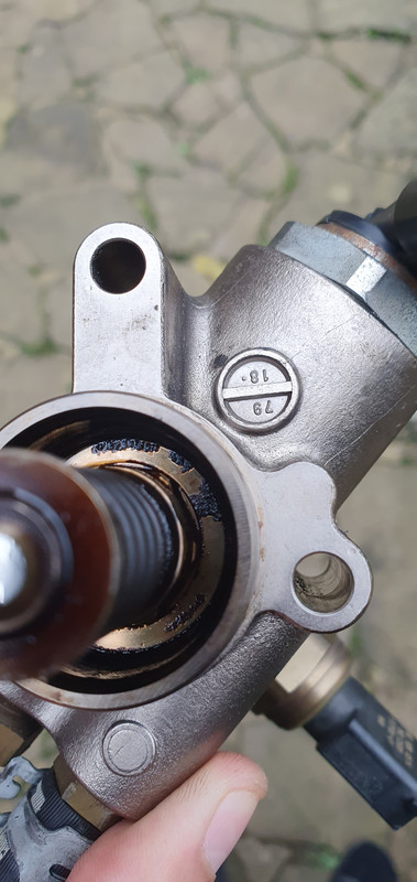

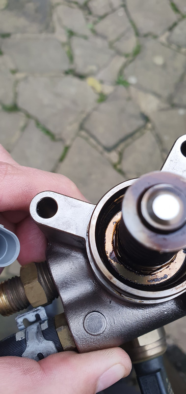

« Reply #3 on: December 07, 2021, 06:01:02 pm »
I've attached some pics of hpfp, maybe there are some tell tale signs you can see..

Re: Fuel dilution in oil
« Reply #4 on: December 10, 2021, 12:19:30 pm »
There is no way of telling physically without stripping it down, but the obvious clues are:
Oil level rises over time
Oil stinks of fuel, and I mean literally reeks of petrol, not the usual rich mixture smell.
MPG absolutely sucks
Reduced performance
Possibly some fault codes about bank 1 mixture from all the petrol vapours getting through the PCV system.
I would say in your case, it's just lots of short journeys. Colder months = more fuel used to warm up the engine, and short journeys don't get the oil anywhere near hot enough to steam off the excess fuel.
