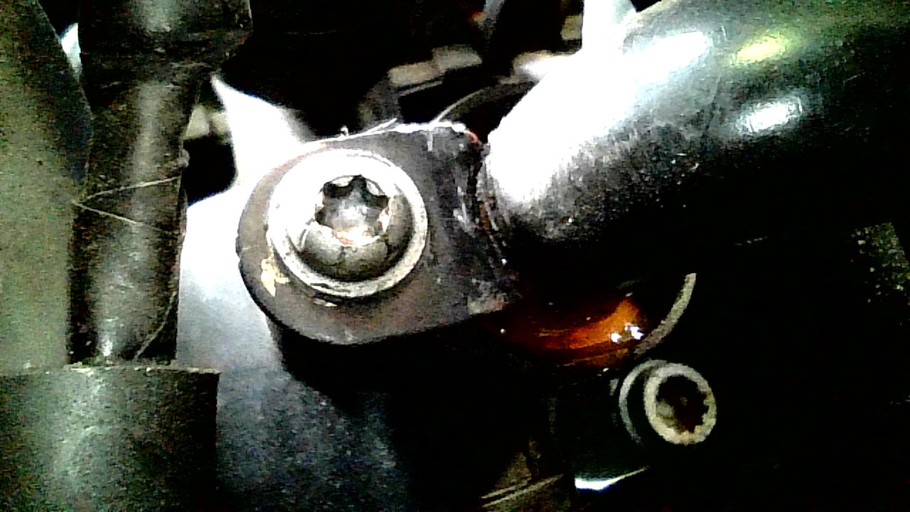

I did some investigating and found coolant around one of the upper coolant pipes on the front of the block, connecting to the thermostat housing. I used my cheap endoscope to take a picture:
Is it safe to assume to is the source of the leak? Here's a diagram of the cooling system, and where I think (based on me digging with the endoscope) it's coming from. Is it worth replacing just that seal or spending €65+ replacing the whole thermostat? From my research part 5 on the diagram below is N90365302 and the whole thermostat is 06F 121 111 F.

« Reply #1 on: February 12, 2022, 10:46:00 am »
Hi fella - it may be a cheap endoscope, but it provides very good images
The work involved to get at the leaking pipe you are not far off being able to replace the thermostat - so yes plan to replace that as well.
It seems odd for the seal to let go, all those parts are held firmly together with no real movement, it could even be a crack in the thermostat body.
Plus also get a new coolant sensor, you can't replace this with the thermostat in the car - trust me you don't want to be going back in there any time soon.

« Reply #2 on: February 12, 2022, 12:46:36 pm »
Probably not a bad idea to budget for the whole housing in case it's cracked.  It could just be the O-ring got pinched or has just worn out/gone hard or something, but as above, with the faff involved getting at the darn thing, I would just replace the whole unit.

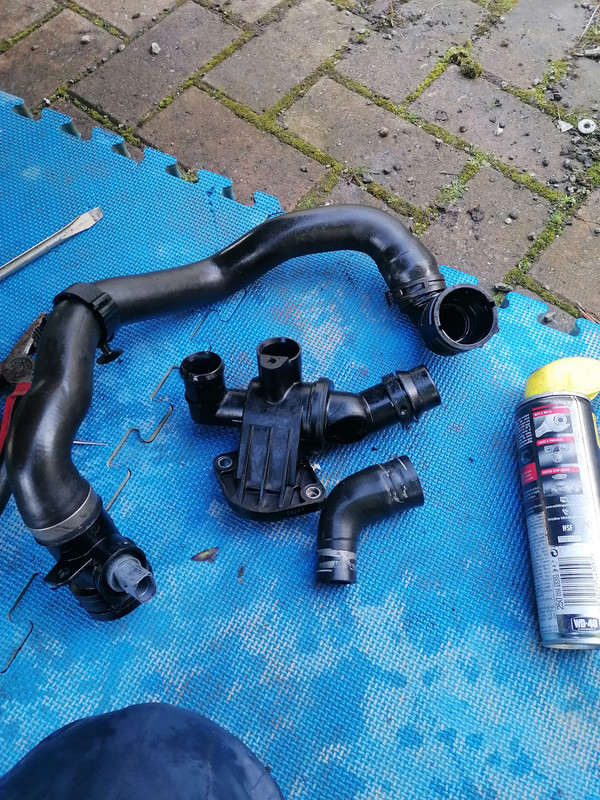

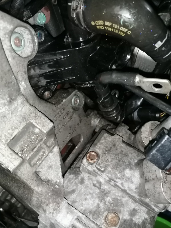

Here's where I am so far:
Here's the hoses that won't separate, right below the red arrow:
Any tips for getting it out?
« Last Edit: February 20, 2022, 07:35:07 pm by OllieVRS »

« Reply #4 on: February 20, 2022, 08:17:04 pm »
You are referring to the part with the grey coolant sensor in it?
I seem to recall they don't really separate- better to just take it out together.
If your looking at the Pelican Parts link, last photo its attached shows them all together - undo the pipework below and it should come out.

« Reply #5 on: February 20, 2022, 08:20:35 pm »
I think I kept mine connected to the thermostat, disconnected it at the other end and then did it onthe bench where I could get a good grip on it.

« Reply #6 on: February 20, 2022, 08:57:02 pm »
Yeah @LC5F that's the one.
Good idea, I'd have to remove the intercooler pipe and then separate that coolant pipe at the radiator. Hopefully that's less of a nightmare than imagine it being.

I followed @Octoparrot 's suggestion, and it worked a treat! 40 min later, every thing is now separated.

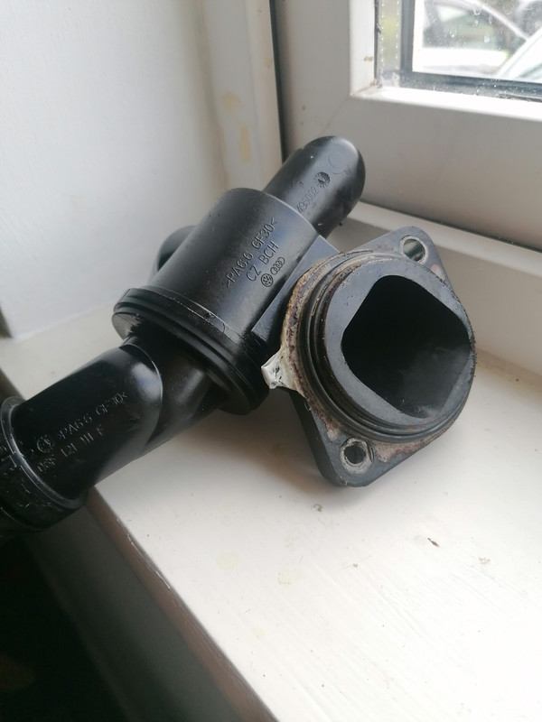

The previous person who did this job used some sort of gasket sealant while putting the thermostat in.
Is this necessary? None of the guides said it was, I thought the o-ring seal is good enough of a seal in of itself.
Picture of the old thermostat with a bit of sealant still on it:

« Reply #8 on: February 21, 2022, 03:12:09 pm »
I never put sealant on mine and it's never leaked, just thoroughly clean the mating face on the block  and around the lip of the hole with some sand paper and it should be ok.
