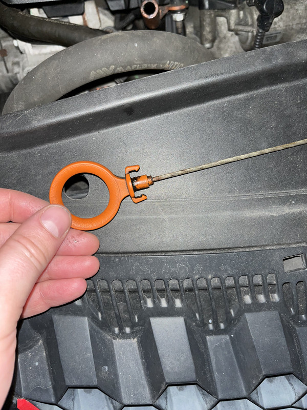

So you know how supposedly the yellow dipstick is a fix for the old orange one that crumbled to bits and fell into the sump?
Turns out it isn't. I suggest keeping an eye on yours. I think I will replace it every 2 years as a yet another TFSI consumable item  :grin:
I also discovered the supplied O ring is slightly too small and causes a small vacuum leak.  I fitted a larger one and it seems to have cured some snatching/surging I was experiencing at very light throttle below 2000rpm. I'm investigating silicone O ring options as they're less prone to deterioration compared to the standard nitrile rubber o rings.

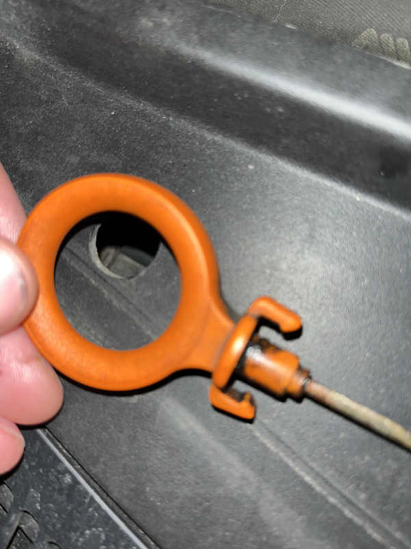

It may seem like the o ring was doing it's job going by the colour difference before and after the ring, but believe me, there was oil on top of the dipstick tube, meaning boost blew it past the ring.
The cracks you see here resulted it those bits separating and falling off with gentle pressure. They were destined to end up in the sump, so I caught it at the right time.

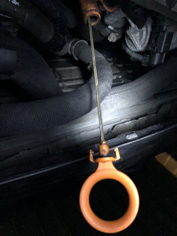

Yeah… think mines seen better days…not even a seal on it! worth changing the filler neck also? Or just the dip stick?
I would change the stick and the guide tube mate  :happy2:  You can see in your pics that oil has made it's way out past the dipstick, so you've got a small vac leak there.  And all the missing bits are chilling out in your sump!

I bought genuine dipstick and tube… I undone the tube nut looked about how to remove it and by looks of it the tube requires a bit more effort to fit so I’ll do that another time as it’s not cracked. I can tell the new dip stick has a seal it clicks into place when pushed in. (Plus the fact it has a seal) 😂

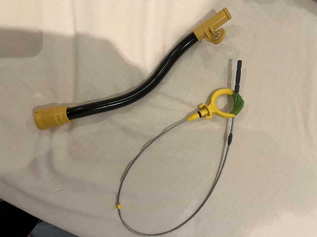

Did an oil change yesterday and there definitely is a big gap around the OEM o-ring - group buy of bigger ones anyone?
Interesting that there seems to have been 3 colours of tube, my original was orange, the genuine replacement about 1.5 years ago was yellow and now there seems to be a 3rd colour of French mustard that GriegC has above, but his original looks to be the same colour.
As we are comparing dip-sticks and tubes here's mine being double yellow, being a bit camera shy:

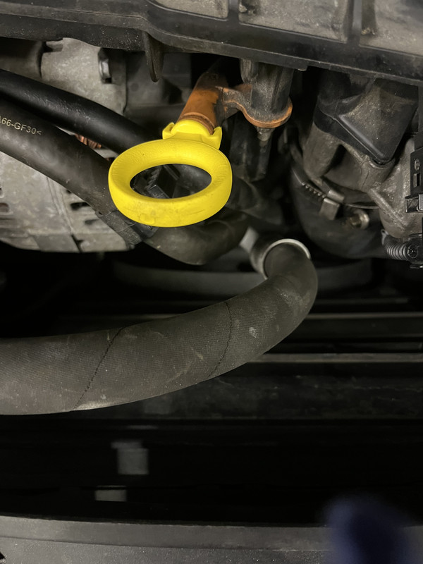

Think mine has seen better days…
Didn’t even realise it was supposed to have an o ring seal as the break is so clean!
