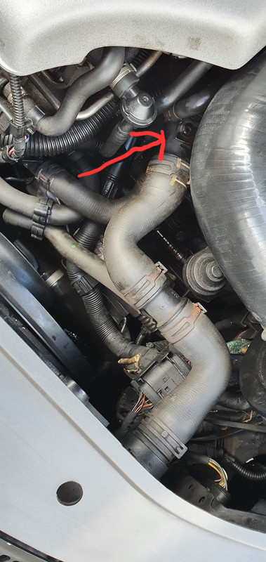

Found the culprit, looks to be where the big top rad hose connects there:

Yes - that's the one Pudding was describing
I manged to get ahead of the curve and replace mine before it snapped off - really terrible design.
Not too bad cost for pattern part, or you get them fabricated out of alloy.
