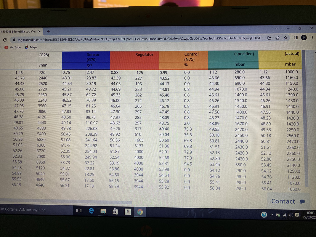

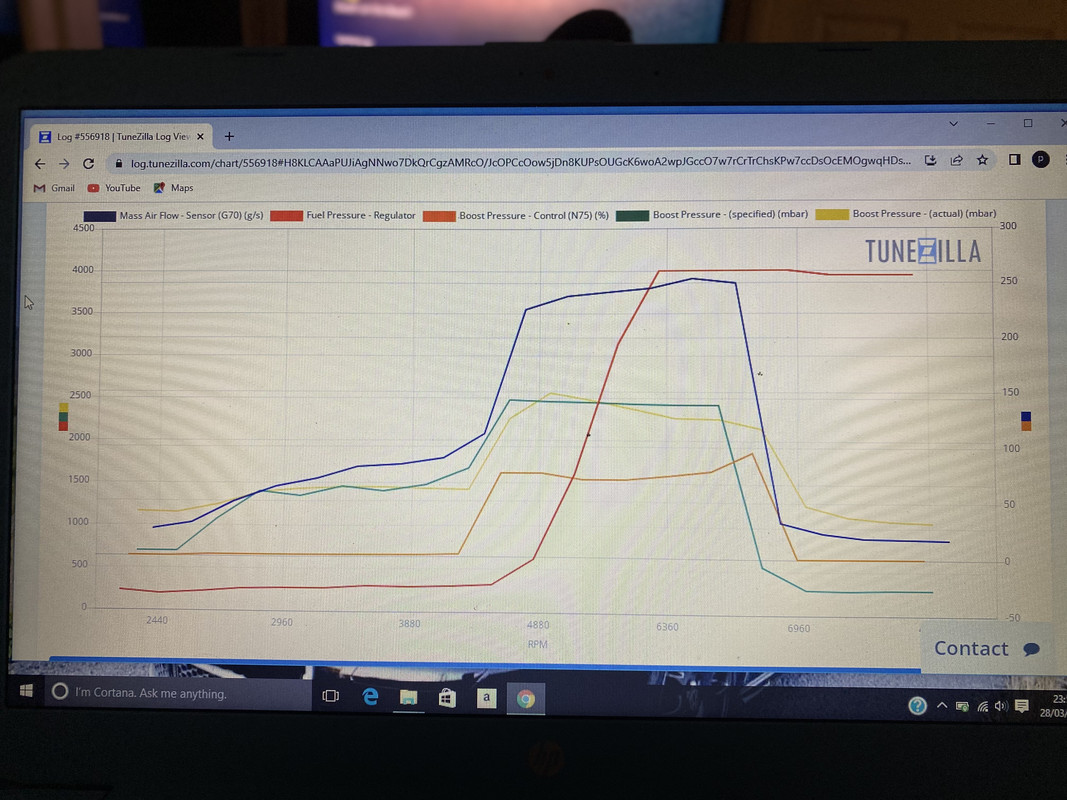

Hi guys logged my car this evening as per the pics can,
Who can tell me if from the log looks good or bad ??
It’s a edition 30

Possibly slow to generate any boost?? but looks like it follows whats requested. Was it full throttle/load? Manual car/dsg??
The others on here will know more.

The two things I would look for are fuel pressure and boost not following specified. I can’t see specified fuel pressure but actual appears to increase and then hold (rather than drop off) so looks fine. Boost seems fine too.

Whats the standard boost for the edition 30? from that it looks like it doesn't generate much untill about 4500rpm?

Yes the boost profile looks odd to me.  It should be hitting a bar of boost way before 4000rpm.  It's only giving 0.4 bar at 4400rpm and then suddenly jumps 1.25 bar at 4880rpm.
A stock ED30 should hit stock boost of 0.9 bar by 2500rpm, a peak of 1.1 bar by 3000rpm and hold 0.9 bar to 6000rpm, and then gradually taper off.
Judging by the 1.5 bar peak at 5400rpm, I'd say it's a remap.  And not a good one.  Either that or there's something seriously wrong with the boost control.
