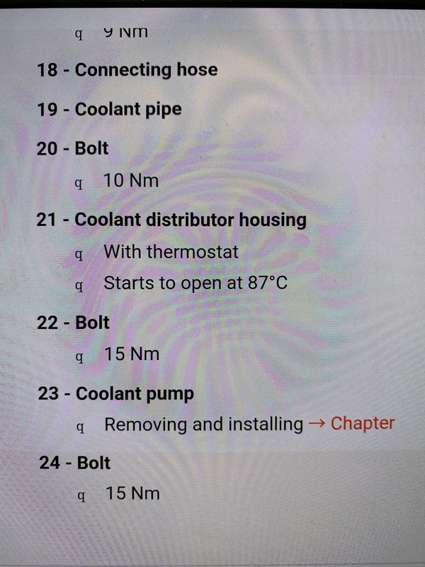

« Reply #4 on: March 28, 2022, 01:44:35 pm »
The “big” thermostat housing to the block is 9NM!
I’ll try to get you a pic with all the torque specs for the thermostats and important change all the rubber O rings!
Offline RBS
  • -Receive: 49
  • Posts: 529
Re: Thermostat housing leak?
« Reply #5 on: March 28, 2022, 02:43:46 pm »
Oops!!! Sorry you were right!!! It’s 15NM!!!

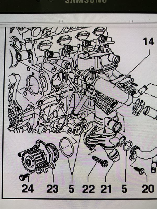

« Reply #6 on: March 28, 2022, 02:48:53 pm »

« Reply #7 on: March 28, 2022, 04:29:55 pm »
Thanks for sharing and yes, 15nm!  :smiley:
That image has got me thinking... I can see that the water pump is very close to the area of the thermostat. It hadn't quite occurred to me that the leak that I am seeing might not be the thermostat housing. Is there an easy way to see if the leak is from the water pump? That would be funny...!
It doesn't quite fit the story, but I think it would be good to double check.

« Reply #10 on: March 29, 2022, 11:06:50 am »
My leak was the small seal on the thermostat labeled number 5, rightmost next to number 20 on the diagram posted earlier. I found this out by digging around with my cheap endoscope and finding coolant around where that metal coolant pipe met the thermostat (but no coolant higher than that connection).

« Reply #11 on: March 29, 2022, 12:48:23 pm »
I replaced the whole thermostat and that seal just in case the seal wasn't the leak and that fixed it.
Already replaced all of the above! Parts from the main dealer.
