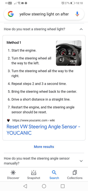

So after getting the tracking checked the inner rods and track rod ends are due a swap. All back together and drives spot on, but.
Yellow steering wheel light stays on. Haven't had chance to pop the scanner on it, will do on Friday as I'm off tomo. Anything obvious to check?
Cheers.

Have you done a full turn lock to lock?

hold full lock left and right for at least 10 seconds  Took me 4 goes  :happy2:

Mmm doesn't seemed to have worked
Offline imprezzaworks
  • Posts: 381
Re: Never straight forward
« Reply #6 on: April 08, 2022, 04:47:22 pm »
All sorted. Got all the adaptions reset and drives spot on.

Started the car to leave work and the light has come back on. Steering seems fine though :(

Orange light means adaptations not met, but should still get power assistance.  Red light means it's f'cked.

Yeah it's the yellow light.
Think it just needs re checking?.. It drives spot on so hoping its an easy fix.
