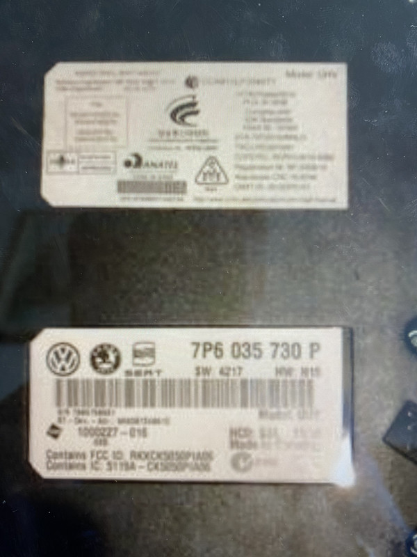

Offline RBS
  • -Receive: 49
  • Posts: 529
Re: Ed 30 Bluetooth connectivity
« Reply #4 on: April 13, 2022, 04:43:23 pm »
Not quite right… I also got the phone & BT function.
It worked from the first day I bought it :wink: might be that it’s a later model??
I know that some people have changed to a Passat phone module, then the BT & phone works to…
I’ll take a pic this weekend and post it :happy2:

Offline RBS
  • -Receive: 49
  • Posts: 529
« Reply #9 on: April 18, 2022, 09:09:42 pm »
Here’s the module wich sits under the passenger seat (Lhd) drive😁
Hope this helps guys :happy2:
