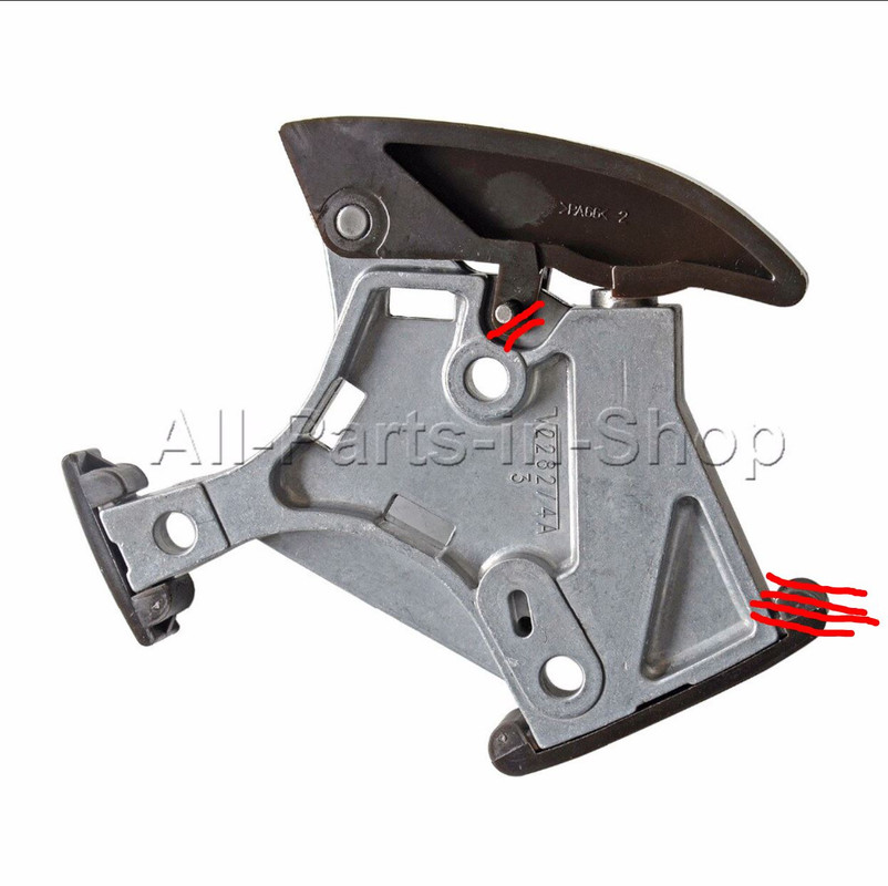

In about a month or so I'm going to be dropping the sump to replace the oil pump chain tensioner as some of the plastic had broken off both making it a potential engine-killer and a pain to put in. I didn't replace it before as I was impatient to get the car running and didn't want to wait 2 weeks for shipping, and I crossed my fingers that if it's constantly soaked in oil it should hold together.
Here is a picture of a chain tensioner with the plastic parts broken off crossed out in red:
edit: (I crossed out the wrong end of the plastic guide rail, it's meant to be the other end where the balance shaft sprocket goes)
I don't know why the tension pin hole was half-broken, probably from poor reinstallation from a previous repair. But the plastic 'guide rail' showed signs of being shredded by a lose balance shaft sprocket in the past. Nevertheless, I'm going to replace it soon.
This makes me wonder if it's worth getting a €205 balance shaft delete VIS Freewheel while I'm in there? I'd do it for reliability more than anything.
On their website it say The simple weight reduction provides a small performance gain 15-20HP which I find rather dubious. Maybe someone could confirm if this holds any truth?

Re: Worth doing a balance shaft delete?
« Reply #1 on: May 03, 2022, 02:00:15 pm »
It can't hurt to give it a try.  I've been in a GTI with one of those VIS pullies and I can't say I noticed any difference as a passenger.
The throttle response might be a little better without the extra drag/rotational mass of the balancers, but it won't show as a 20hp gain on the dyno!
« Reply #2 on: May 03, 2022, 04:21:33 pm »
Thanks for the reply Pudding.
I'm probably not going to get it then if it's 205 euro (+cost of oil and time if reverting back to oem) for something that I don't urgently need. I suppose the next time I get the panic-attack inducing, flashing and beeping red light on the dash, I'll look into it again. smiley:
When I inspected the oil pump's balance shafts last October they felt smooth enough and there wasn't any play, so not too concerned there.
I already have the same mysterious hot idle shake others have, so I wouldn't want to add more vibrations on top of that, nor am I fan of putting extra strain on the engine mounts.
I'm only planning on getting a stage 1 map to accompany my air intake, which means I'm not planning on raising the redline, which is another reason people get these freewheels.
