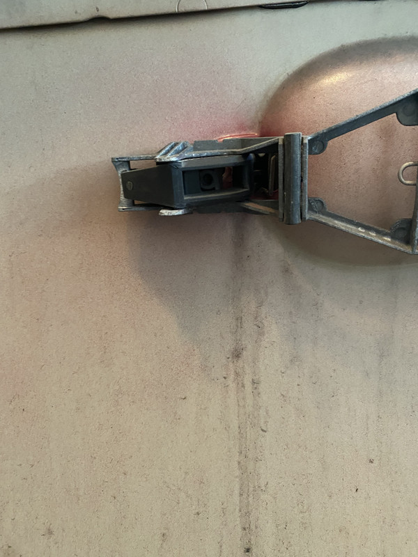

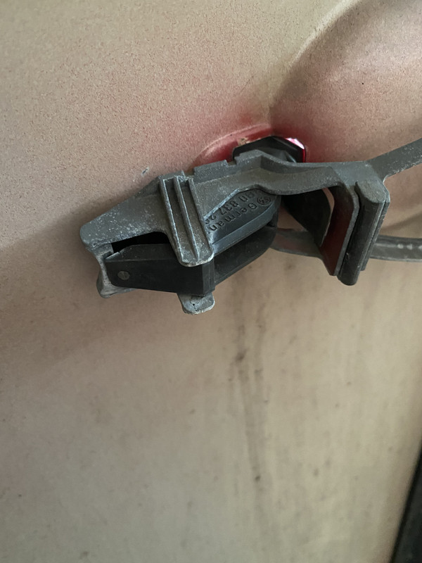

This is turning out to be hilarious, I have to door skin off inc the handle and have cut through that little screw…I STILL cannot get this handle off 😂😂😂 I’ve got the rear of the handle out and now it should just pull out easy as…nope. It’s like the front part of the plastic handle is connected to the metal cage and will not release. Doesn’t even pivot. I’m actually bending the cage trying to wiggle the handle free 😂😭 What a car.

Well it’s off now, seems the issue was the handle was caught up against the metal cage…just simply wouldn’t pull out. Cage is destroyed so will be buying a new one then put all back together properly this time. What a piss about

Dremmel what exactly? I hacksawed the screw off at the start today (while the door skin was still attached to the car)  to release the handle but still wouldn’t budge. It made zero difference. In the end I took the whole door skin off inc the handle and took it in the house to sort where it was warm enough 😂…still couldn’t get the thing off AT ALL with access to both sides. Turns out a bit of the plastic handle was caught on the metal cradle preventing it from coming off. This was only discovered after I had to wreck the cradle to see what was stopping it. Something had to give or I would still be there now 😂😂
