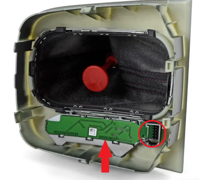

It's going to take some electrical diagnostic work to determine where it loses communication.
I have seen this once when a DSG gear selector board wasn't reporting which gear the shifter was in...but only the one time. Also, I cannot recall the fault codes associated with the one time...so this may not even pertain to your situation. This is where the circuit board is and the only way to replace is in doing so to the complete shifter assembly (as shown in this pic). You may try finding a used shifter, costing little...just to try. If you do this, you need to do so with care. As you can damage the current shifter when attempting to remove it. You wouldn't want to if there is nothing wrong with it.
Video shows how...I know it differs, but removing this style is done the same way. I recommend disconnecting the wires before pulling the shifter off...shown at 1m45s. Leaving the wire connected here is when it can be damaged, as the wire can break the board if left connected and you pull too hard;
