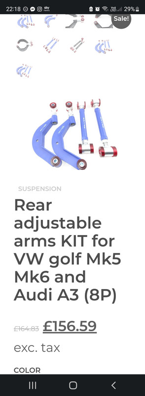

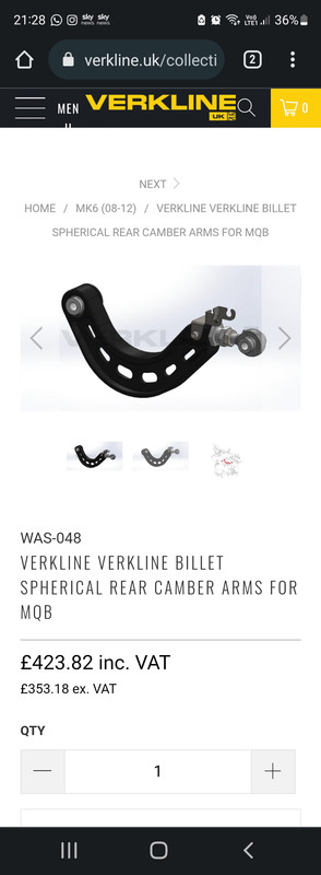

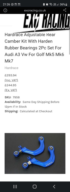

I've been looking at upgrading the rear end on the race car build
Option wise I see there are arms available from Virkline, Hardrace and Silver projects.
Virkline stuff looks amazing but is crazy money.  Silver Projects is quarter of the price but looks flimsy in comparison. Hardrace aew in between price wise but look sturdy.
Any experience?

Yeah the Verkline stuff is crazy money.  Darkside Developments use it on their race cars, and from what I gather from Ryan's comments in his YouTube videos, it doesn't seem to bring a whole lot to the party in terms of slashing lap times.
Spending £1000s to shave a couple of seconds seems like very poor VFM to me!
I've never understood the business model of a small company charging that kind of money for welding a few pipes together.  How many customers do they expect to attract at those prices?

I'll probably be going hardrace on the rear i think.   Maybe in the future I'll consider throwing the anti squat arms from verkline but not yet.
