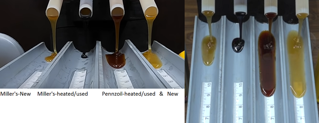

Now this is all stuff I have found recently. So this is the viewpoints and statements of others and not my own: I've seen one test where Miller's Nanodrive becoming super thick and gooey after a heat test and then chilled. I know everyone says it protects well and is Ester based and all, and that's all fine, but this would seem to be a problem once it has been used a bit and it gets cold. I wouldn't have believed it myself without seeing it. The other oil it was tested against performed very well in a cold pour test at this point in the test (following being heated for some time), but Miller's just stick within its chute and barely moved down it. I have also seen a post on facebook TFSI (R-Tech's page) where someone contacted Miller's and asked if their Nanodrive 5w40 was right for his car, driving style and intended intervals. He reported they told him no. It is more suited for racing where it will changed often.

Can you share the details of the test? Would make interesting reading.
Sure, I actually just found the video. Didn't think I would, but I remembered it was one of Miller's Nanotech 5w30 offerings compared to one most wouldn't likely consider, Pennzoil Ultra Platinum. The test does prove Miller's has a good amount of Wear Additives but evaporates more and gets quite thick when cold.

Here is a snapshot of the beginning of the cold pour test:

Good old Project Farm  :happy2:
Regarding the cold test, the UK will never see temperatures that low but it's still interesting to see how stodgy it gets though.

Yes - I saw that vid ages ago, it made me think about all the peeps proudly using nanotech on here.
