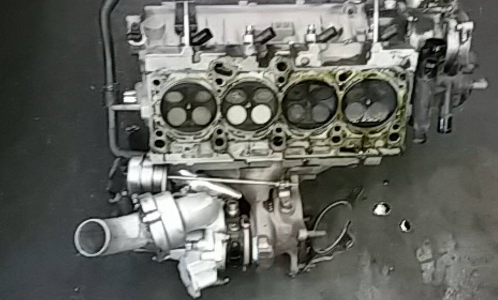

My engine is definitely not healthy. It has suffered low oil pressure twice during my ownership and at least once in its previous ownership, based on physical evidence on the oil pump (scratches showing that the balance shaft sprocket had come lose in the past). It has had far too long service intervals too, which I stupidly ignored while viewing the car.
The compression is 145psi, which is far worse than what @ald1717 said he got in his post from a few hours ago and my mileage isn't that much greater at 121k miles.
Two of the exhaust valves were found to be slightly wet with oil when the turbo was being replaced by my mechanic, but nothing drastic. I expect this to be a major cause of the oil usage, other than the piston rings. I can't say 100% it's as much as 0.8L/1000km since I live in a hilly area where it's hard to get an accurate reading, but it's my best estimate.
But I have replaced the connecting rod bearings (in situ), as they were pretty cloudy with a few scratches when I took them out. Thankfully the crankshaft looked fine, but I took a risk and didn't measure its diameter.
I am planning on running this engine till it dies, with a replacement rather than a rebuild in mind, since it's already gone through so much neglection. The rings, pistons, cylinder walls, valves etc would all have to reworked/replaced I think.
Yep, the head needs a rebuild.  Exhaust guides always the first to go on VAG engines.
Fitting a refreshed head is a quick way to restore compression and reduce oil consumption.....providing the cylinders/pistons aren't screwed.
Don't waste time or money with spark plugs, that isn't your issue.  It's just a tired engine, but hopefully just the top half.  A new engine will be 3-4000 from TPS.  I would sell the car now if I were you.  The money pit only gets deeper.  There's always something with these engines......just when you get it running how you want, the bloody injectors go down and that's another £800 + labour.  It never ends.

Also here's a video I posted before of the valves, it's not that bad right?  :wink:
