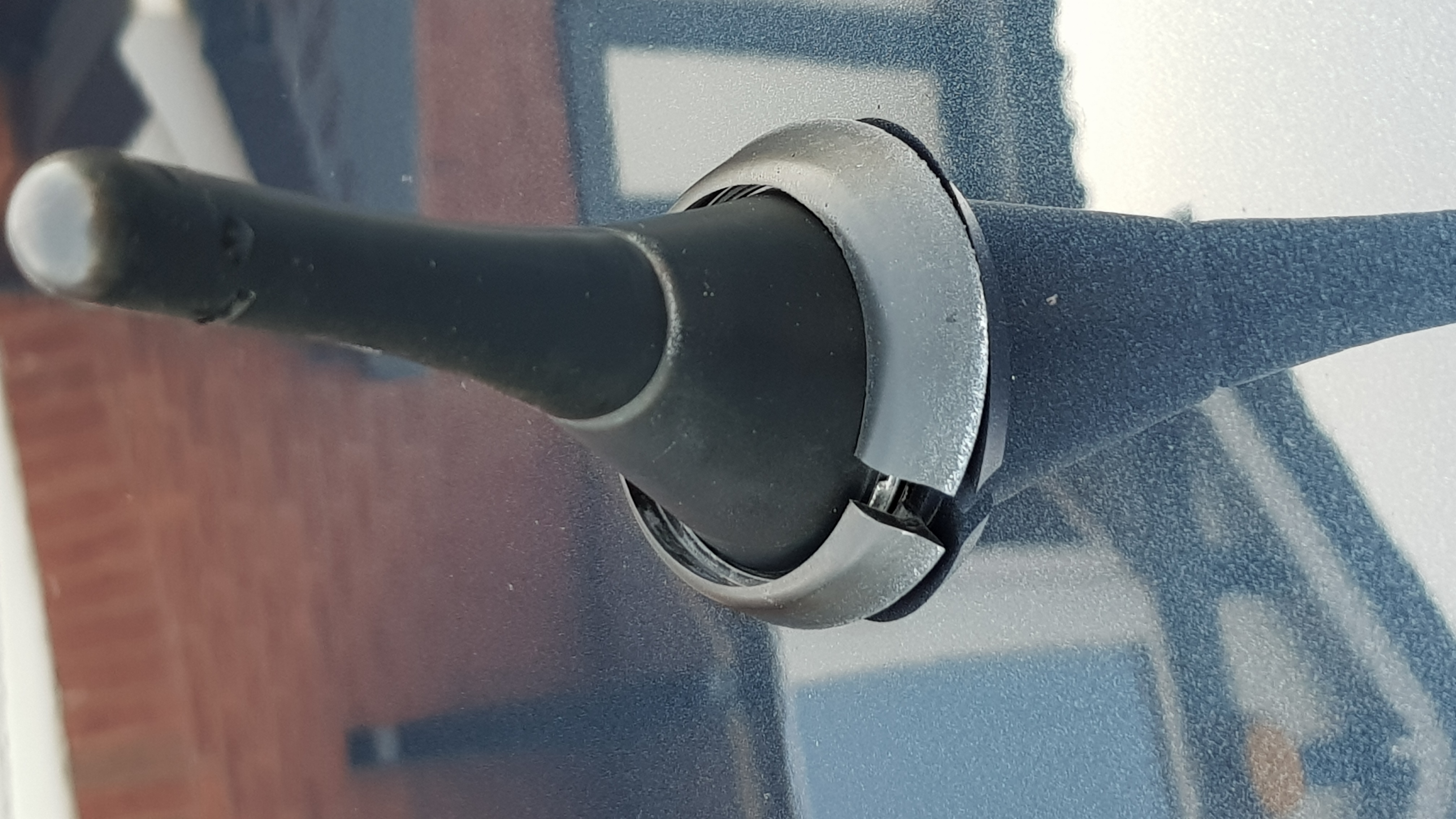

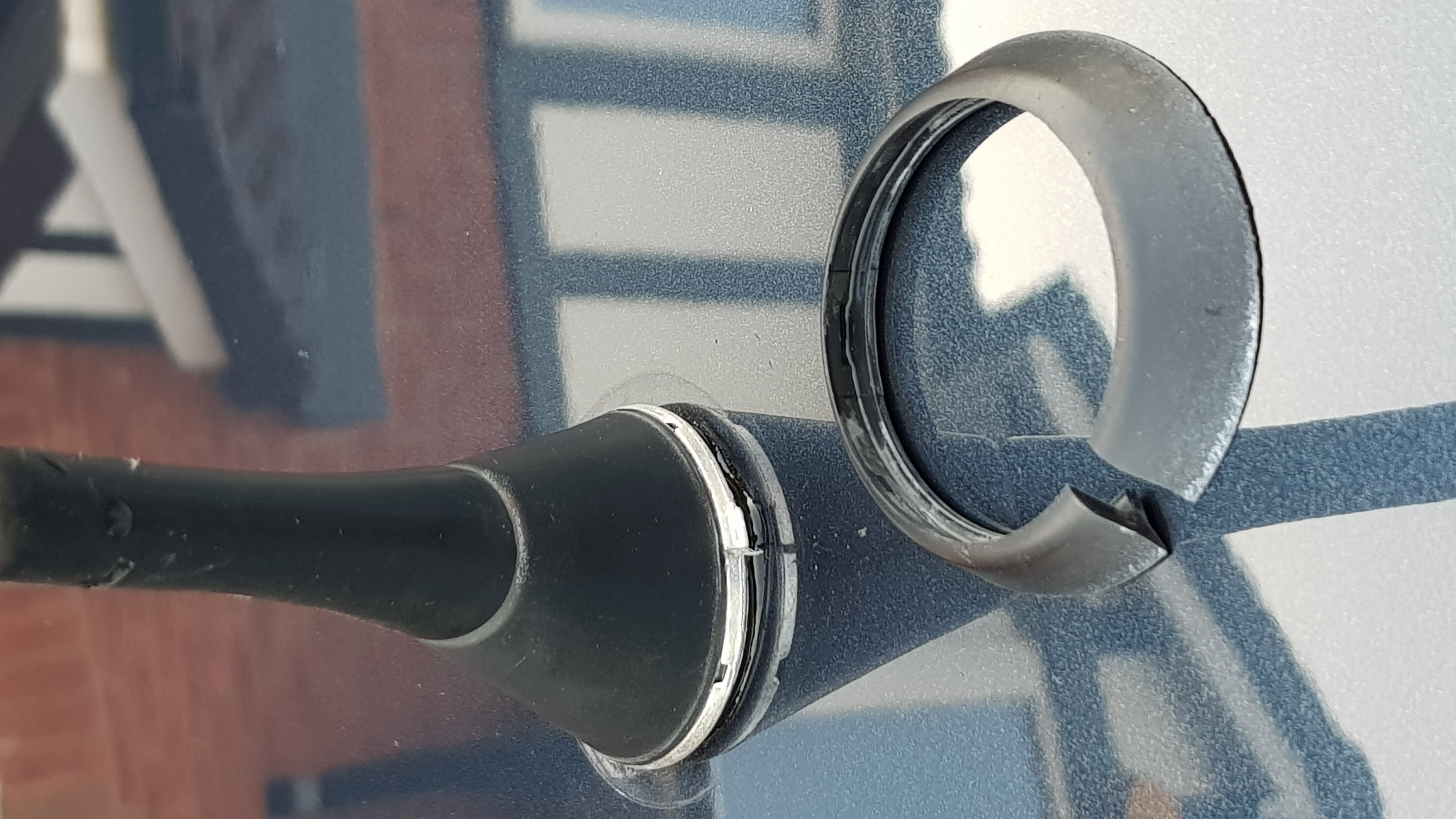

The hard plastic that surrounds the base of the aerial on the roof of my car has cracked.
Is this part sold separately?

Yes.  Ebay have them just search for golf mkt aerial rubber gasket.
I changed one on a MK4, they are rubber, so if you put it in hot water it gets soft and you should be able to stretch it over the base without needing to remove the aerial.
Yes I changed mine a couple of months ago using the above method and also a little red rubber grease.

ordered one from ebay and hope it looks oem when fitted.
