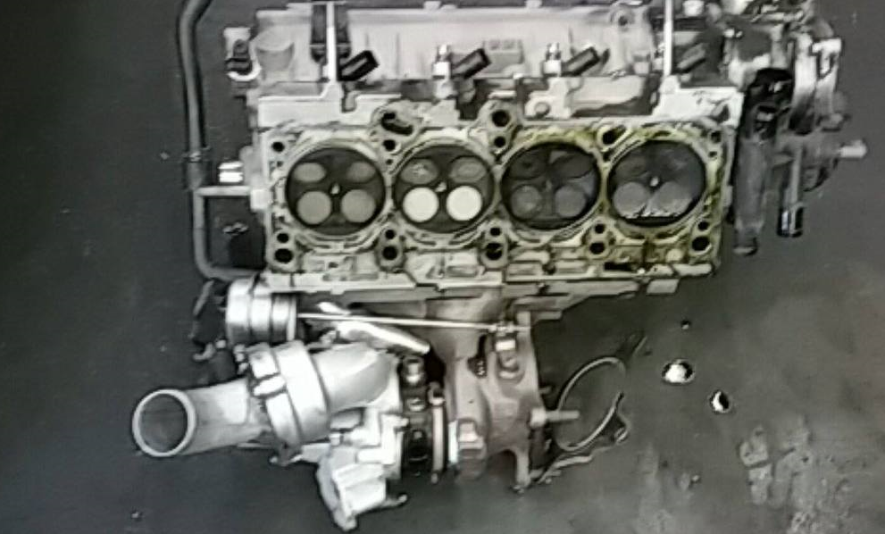

hard to say there always seems to be a fair bit and i do get the occasional puff of smoke from the exhaust if ive been cruising for a while then com on boost but ive been told this is normal vapours burning and i do have a bigger down pipe and 200 cel,
Mine was rebuilt at 120k miles. When it first began to release a small puff, was right after lifting the throttle after putting it into boost. Then what it developed was; if I stopped after having it in boost, it would puff again when going back on throttle when rolling from a stop. Eventually it got to doing this more often and produced a more embarrassing cloud. Mine turned out to be worn valve guides, valve stem seals, and rings becoming stuck in the pistons of #3 and #4. In this you can see how much more oil was in the #3 and #4 combustion chambers:
