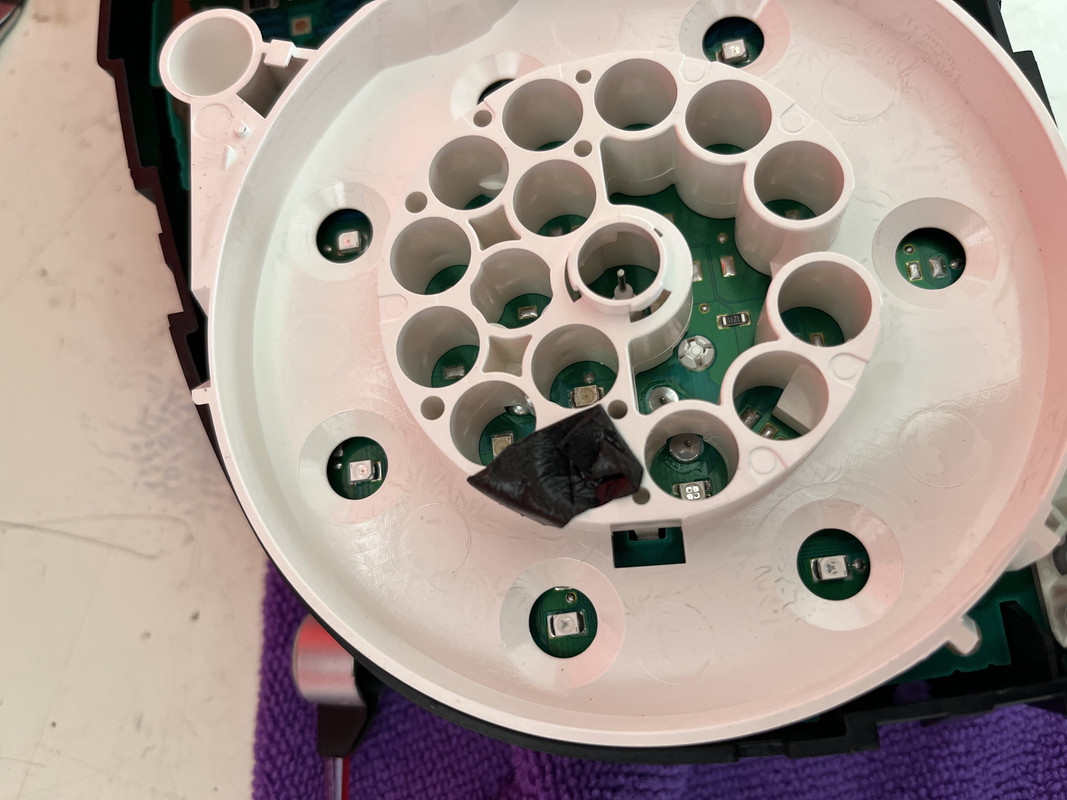

It might of had the issue before the K04 kit and tune because the awful previous owner had the check engine light covered up!

No, the car wasn’t tuned before. Though after the tune is when I noticed the covered up engine light from the previous owner. And then realised the light was on.
