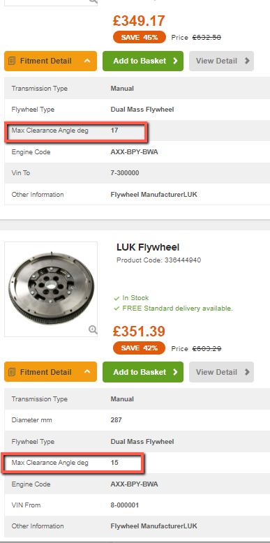

The thing with my GTI (2005) flywheel is it shows two variants 15mm and 17mm clearance......mine being the 17mm version going on chassis number and assume the S3 kit is 15mm being later engines

Sounds about right on the torque specs but I'd check with AKS Tuning on the flywheel as they don't specify engine type in the link!
