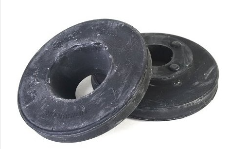

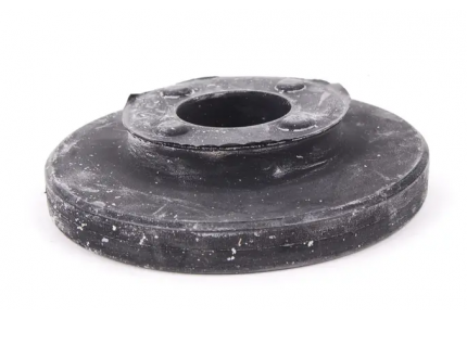

Golf GTI ones are quite thin
and the TT ones are a lot thicker and give an even stance all round
https://www.akstuning.co.uk/shop/home/1196-audi-tt-rear-spring-rubbers.html

I got mine from TPS but AKS are a good alternative source

And here's me thinking I'd need different springs! I'll get them ordered, can't complain for £13!!  :happy2:

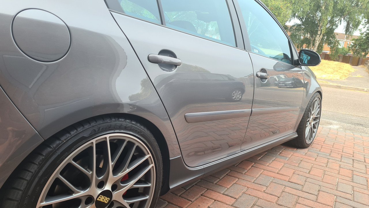

Here is a stance shot of mine

Cheers for that, best colour too  :grin:
