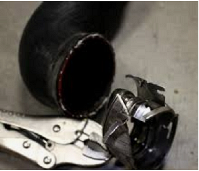

I've also seen some go a little nuts when removing them:
