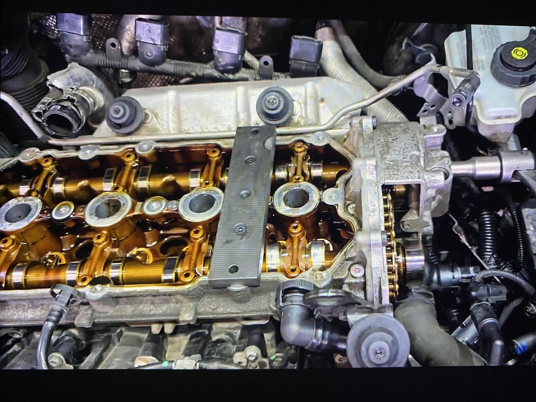

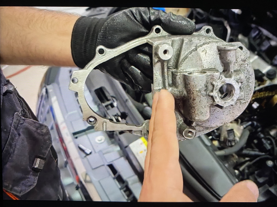

There is also another way to loosen the bolt!
You get yourselve a second hand camchain cover, cut half of it off so you can see what you’re
doin. Bolt it back on but put the bit on the bolt first then a short extention and a breaker bar.
That worked fine  :happy2:
I’ll post Some pics of it when the uploader here works again!?!
I can’t upload pics for some reson?
Offline RBS
  • -Receive: 49
  • Posts: 529
Re: Cam chain replacement
« Reply #20 on: October 21, 2024, 04:00:03 pm »
Succes😎👊🏻
Hope this helps you guys.
And it’s better to have a help when losening the bolt! Someone to counterhold the camshaft sprocket.
Enjoy 😉
