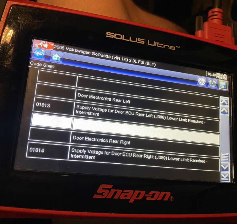

I also pulled 2x codes, however I’m not sure they’re totally relevant as this maybe the effect from this issue:
Code: 01713 Supply Voltage for Door ECU Rear Left (J388) Lower Limit Reached - Intermittent
Code: 01814 Supply Voltage for Door EU Rear Right (J389) Lower Limit Reached - Intermittent

sounds like the door module could need replacing?
