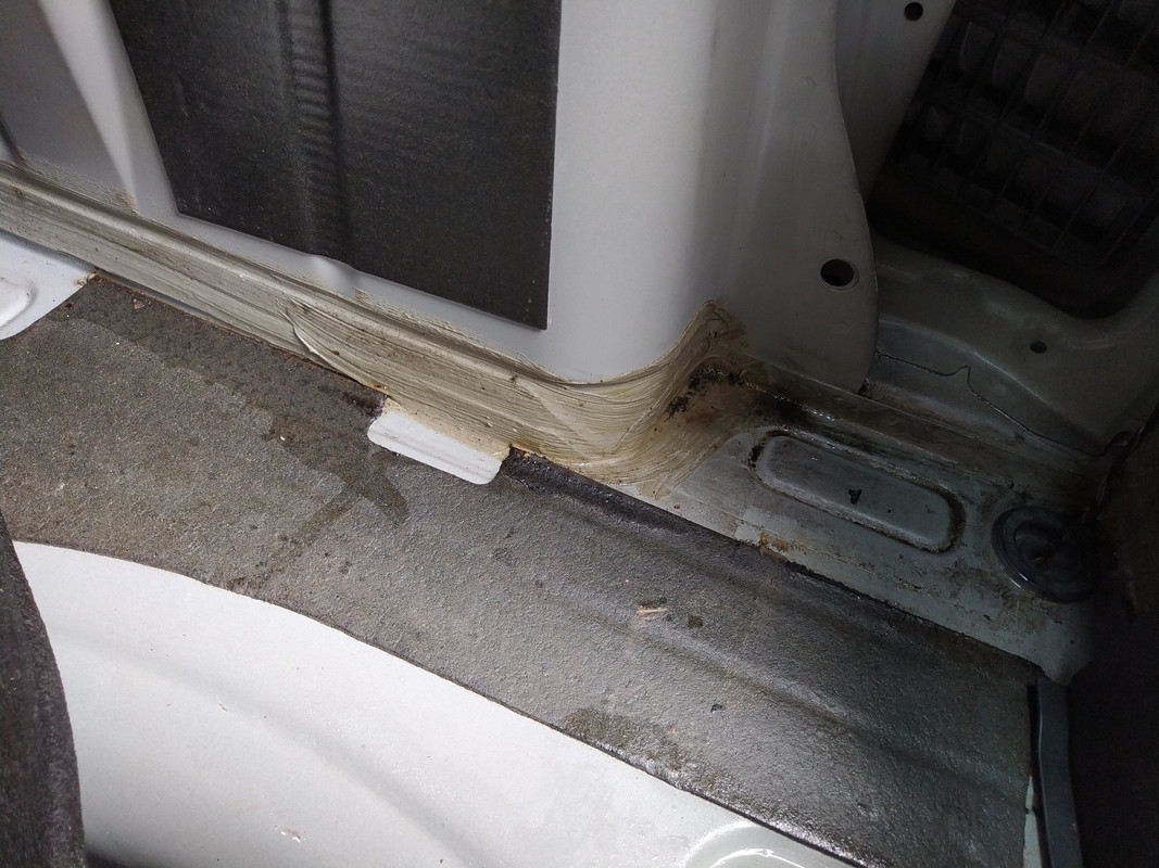

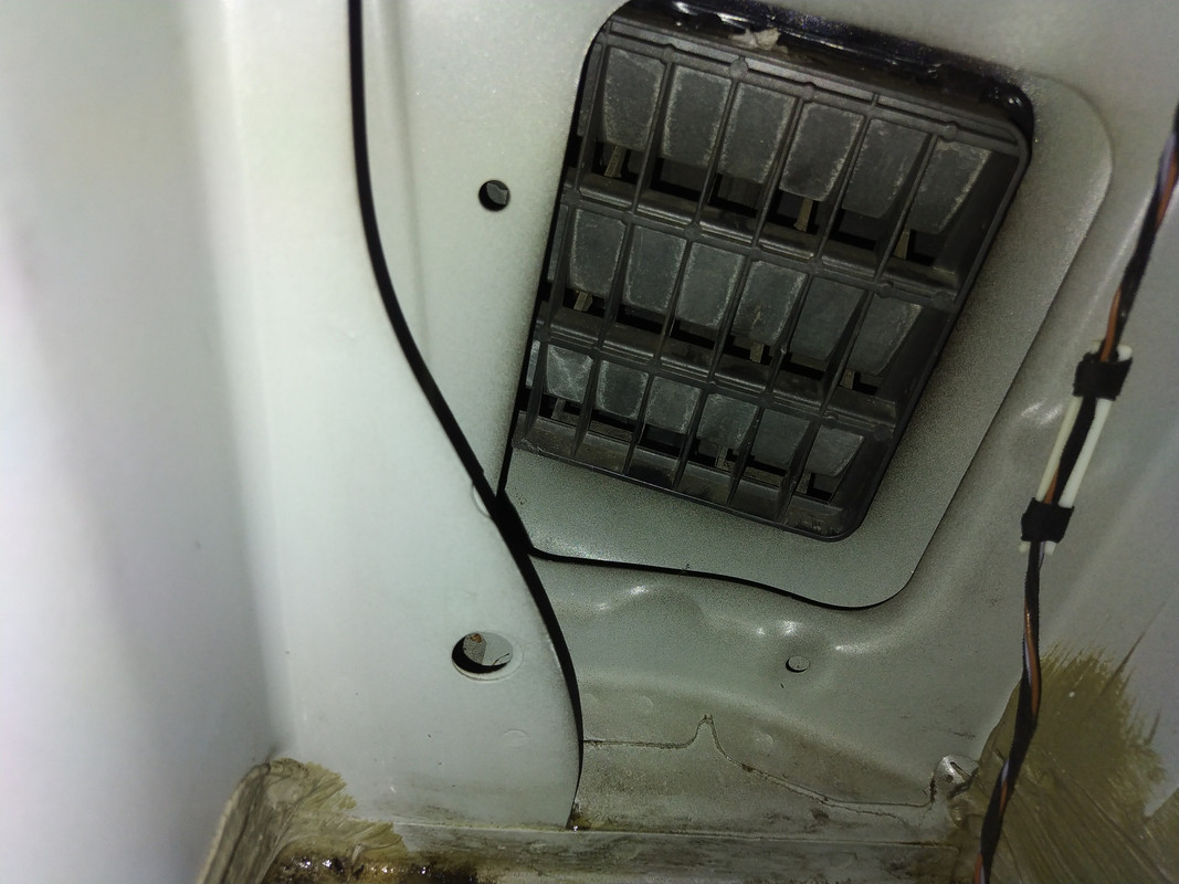

Still can't get to the bottom of this. The vent is surrounded by black sealant!

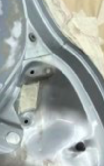

I had the same problem ,after a lot of looking discovered after removing rear light it was leaking from behind it the top grommet hole.
Same here. After I, ahem, lost one of the cap nuts whilst changing a light bulb
