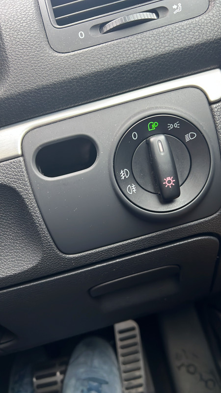

Does anyone have the part number for the dial next to the headlight dial which does the dash illumination only?
Mine currently has the dash illumination and headlight level adjust but due to boring MOT reasons I need one without the headlight adjustment.

I can have a look at lunchtime if I can prize it out easily without tools.
I take it your xenons were retrofitted?

Yes they were.
To take it out you have to remove the cubby below, reach up and there are two tabs one on each side of the unit and it pulls straight out.

1K0 941 334 B

Brilliant. Thank you.
