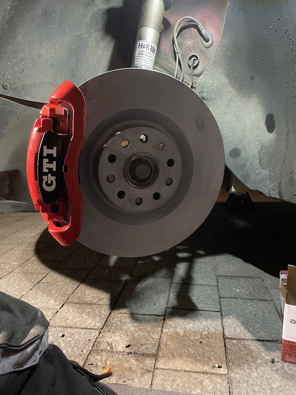

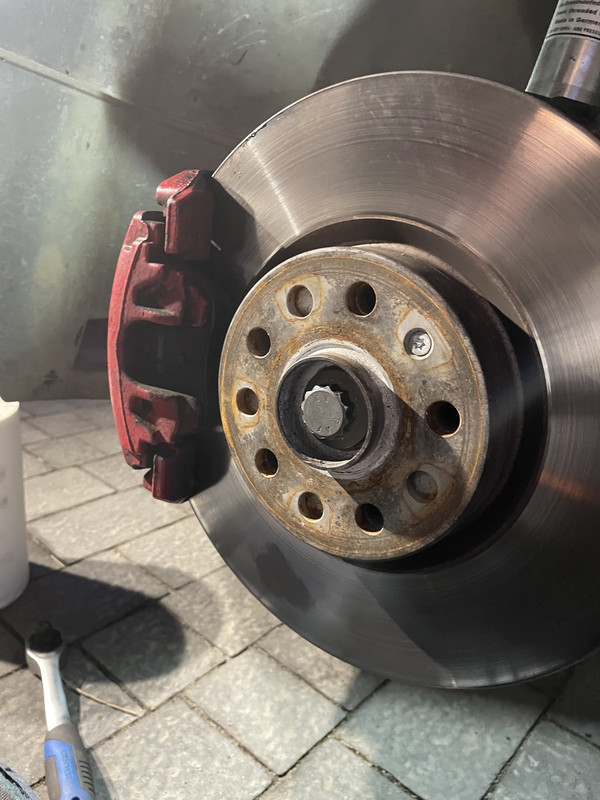

Had the weekend to myself so got stuck into the brakes.
Hiw it started
And the end
That was a decent amount of work, made a huge mess bleeding everything, but it seems to have turned out right in the end.

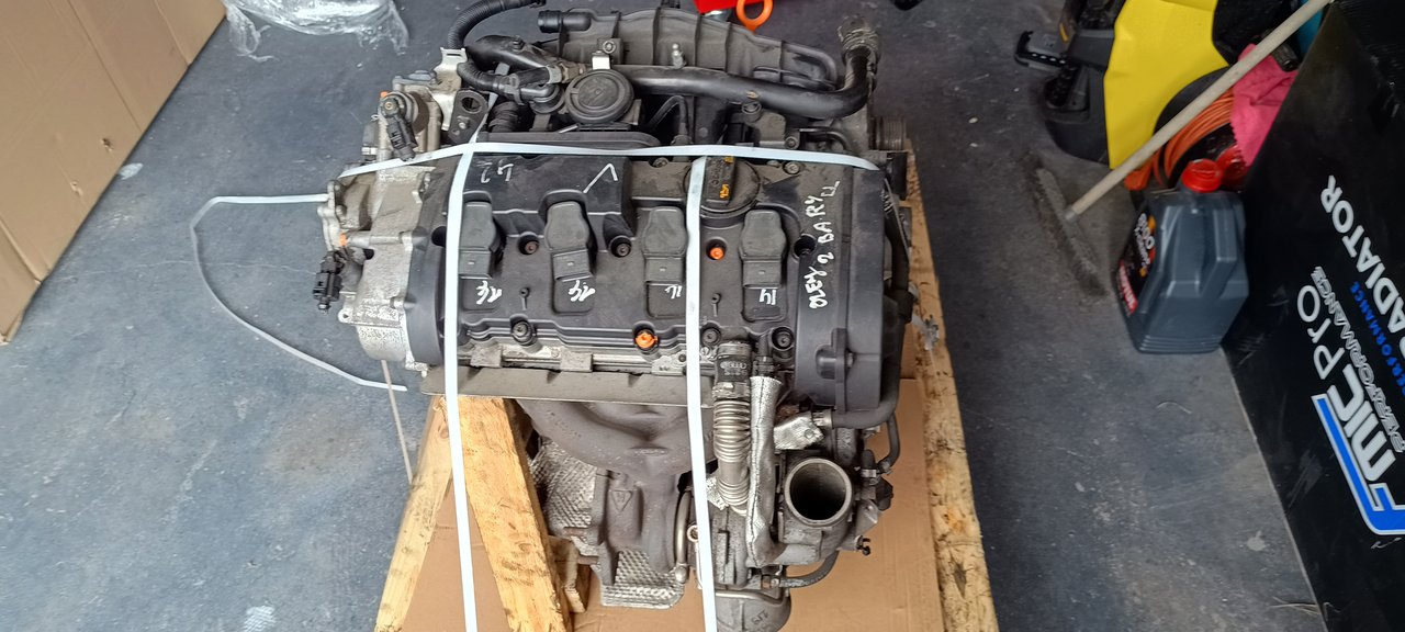

Used BUL engine from an A4, high mileage but the seller did compression and oil pressure checks and all good (according to them)
Plan is to spruce this up a bit, and throw it in while I rebuild the old engine for powaaa!

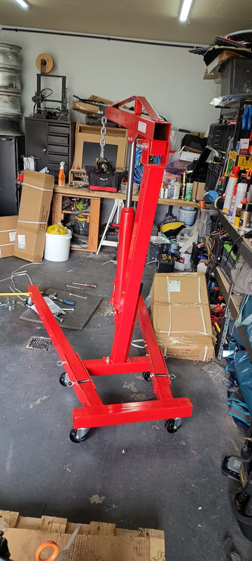

Workshop tools purchased, there's an engine stand and lift still in boxes.

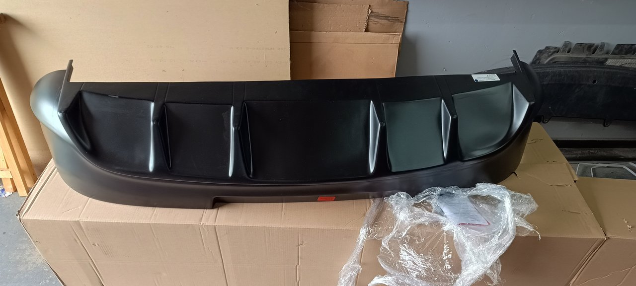

Lastly I'm tired of looking at the stock rear end:
This just arrived from ingo noak in Germany.
