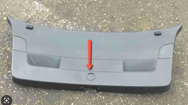

The wires in the loom are broken near the hinge (left side)
Common issue and will require you to fix the loom.
The boot can be opened manually from inside the car via access hole
