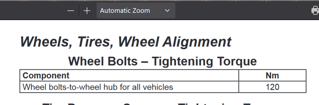

Just doing a ceramic coating all wheels off job, VW’s own data says 120 nm.

It isn't 120 lb*ft.
It is 120 Nm or 88.5 lb*ft.
