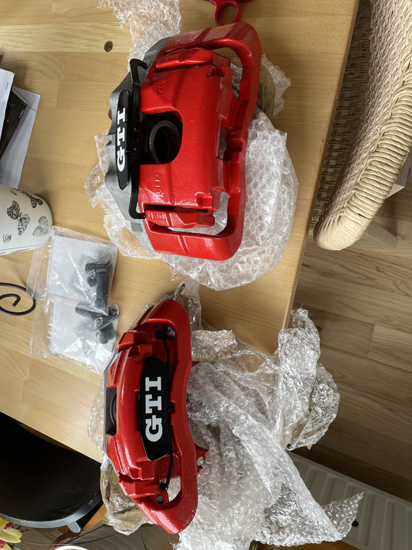

My understanding is 8P but I'm not 100% because the seller couldn't tell me the origin as he got. Them used and refurbished them, just that they're off an audi.
Pic if it helps: (ignore the GTI badges, that's custom)

your original lines will be fine.
I fitted GTI PP calipers with the OE lines (on a mk6)
if you want you can buy custom braided lines but the jobs more involved

I've recently done the same as john_o on my MK5 - used the stock line as removing the full line can create a lot of extra work if they don't come loose. Undoing the caliper side is easy however - torque setting 20Nm.
