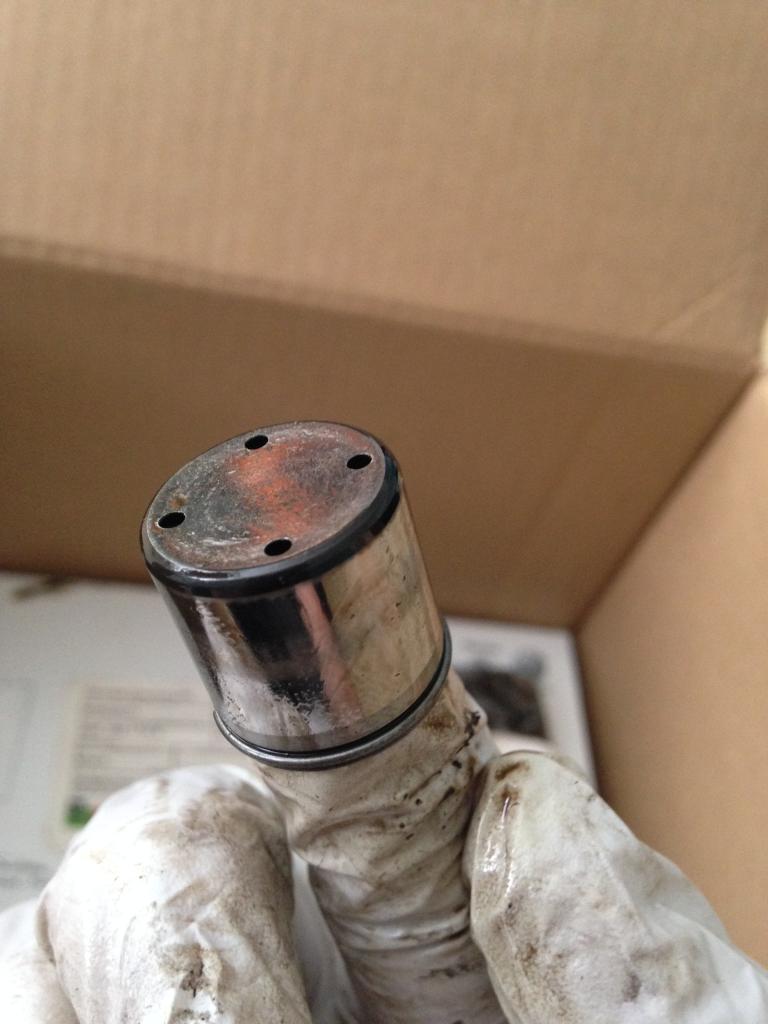

Cam follower having done 60k
[/URL]
The worry was that not getting the cam shaft replaced would cause problems further down the road, but costs were eye watering!
To cut along story short after nearly 3 weeks I have the car back and on the initial run home its running better than ever having had the cam shaft, cam follower, timing belt & chain + associated tensioners, hydraulic adjusters changed.

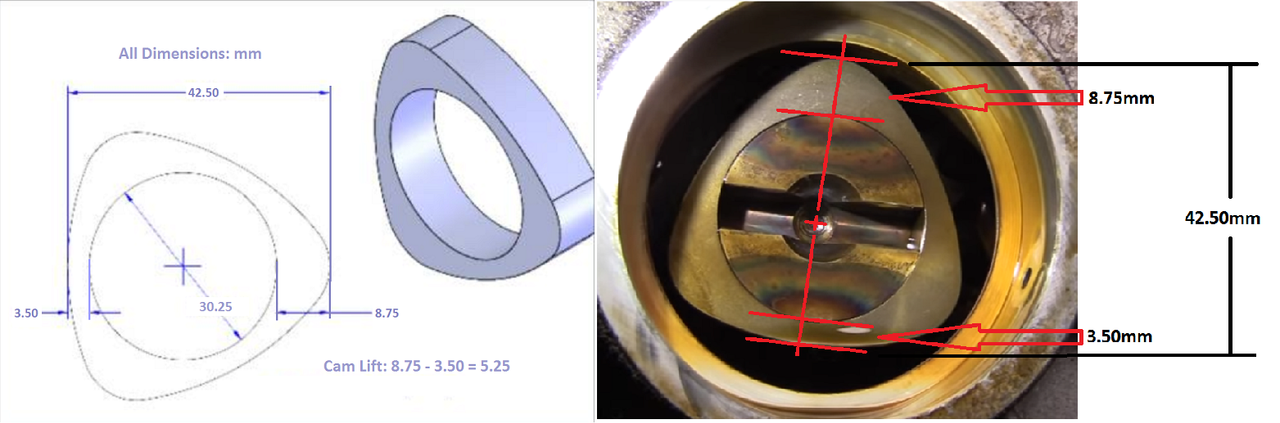

Yes...topic is camshaft sensor. But someone may pull this up regarding camshaft wear.
So, this is the tri-lobe specs. It only takes a loss of 1.0mm to 1.5mm for the HPFP to struggle to make its actual pressure match the target pressure.
