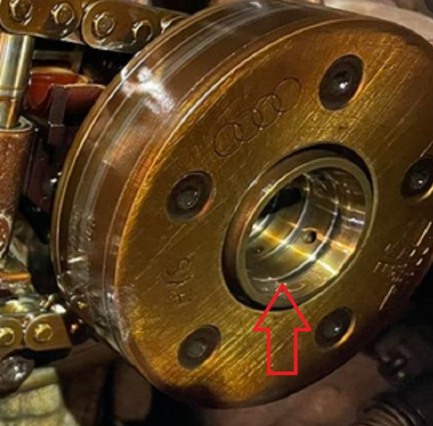

When the chain and tensioner were done, they may not have cleaned the N205 pickup screen. They may not have inspected the three oil control rings...or they damaged a ring when reinstalling the cam adjuster/chain cover. Because those three rings go into the center-bore of the cam adjuster. If the first ring catches on an edge, and is forced a bit, the ring can break.
This is a broken ring and the other is the location for the N205 oil pickup screen;
One more thing; if your MK5 is older, those came with metal rings...not plastic/nylon or whatever they be. And the metal rings would groove the center-bore of the cam adjuster like this and eventually lose oil there;
