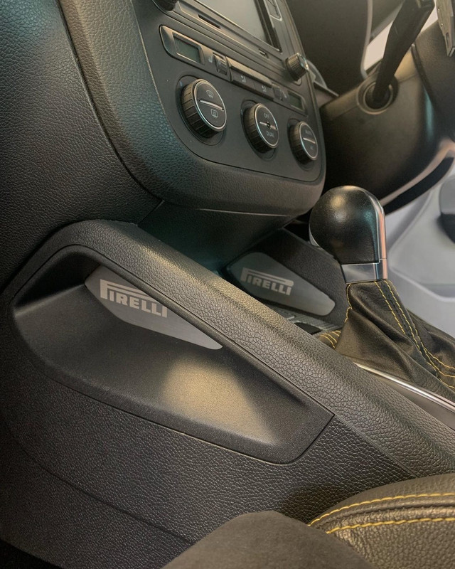

My custom Pirelli insert were installed and made the interior really pop even tho there small they do make that much of a difference

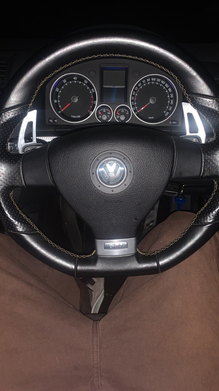

My last bit of cosmetics for a while were installed, yellow fog lights with I wrapped myself with yellow vinyl off Ali express along with black eye lids to make the car more aggressive looking , I also added paddle shifter extensions, now it was time to actually put money into the performance side of things

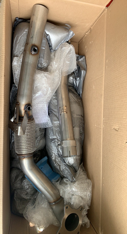

First big mod was the 3’ catless down pipe from miltek I chose this because i already have a 3’ cat back on the car from the previous owner so it was an easy install and fit, car sounded so much better after and surprisingly with it being catless there was no drone at all, I went catless for performance reasons and here in NZ they don’t check for cats

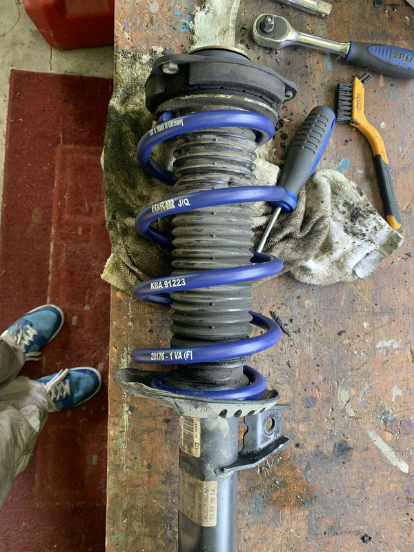

I purchased some H&R 30mm lowing springs as these were recommended to me and local, car sits a bit lower but not stupidly low, so I liked that, after install the ride was a bit stiffer but not as stiff as I wanted it but that’s okay, if I was to do it again i would go for a stiffer spring and maybe a 45mm drop

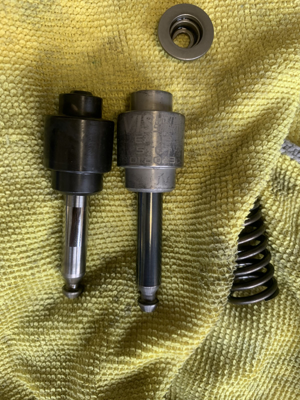

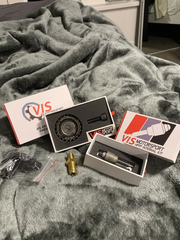

Some parts have arrived, my VIS BSD, VIS HPFP, AKS runner flap delete and rs4 FRV had arrived along with a rev G diverter valve wich I already had on my car but oh well new stuff Is better than old.

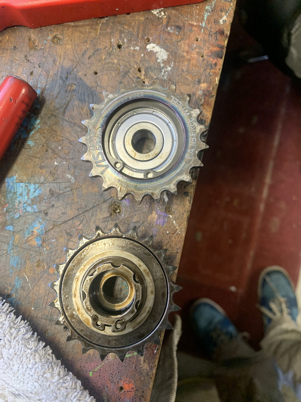

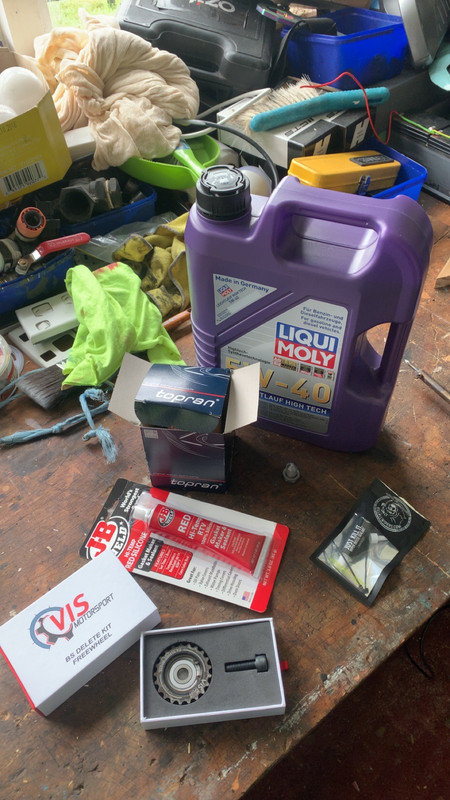

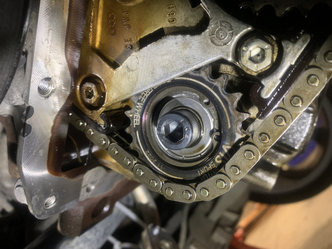

Next do do was the VIS balance shaft delete, fairly straightforward was a it of a pain to tighten everything up but otherwise only took a hole day 💀. I also did a fresh service as it was about time at this stage, after this install I did notice the rpm climb a bit quicker, and the car vibrated a little bit more but you can’t really tell once you get used to it.

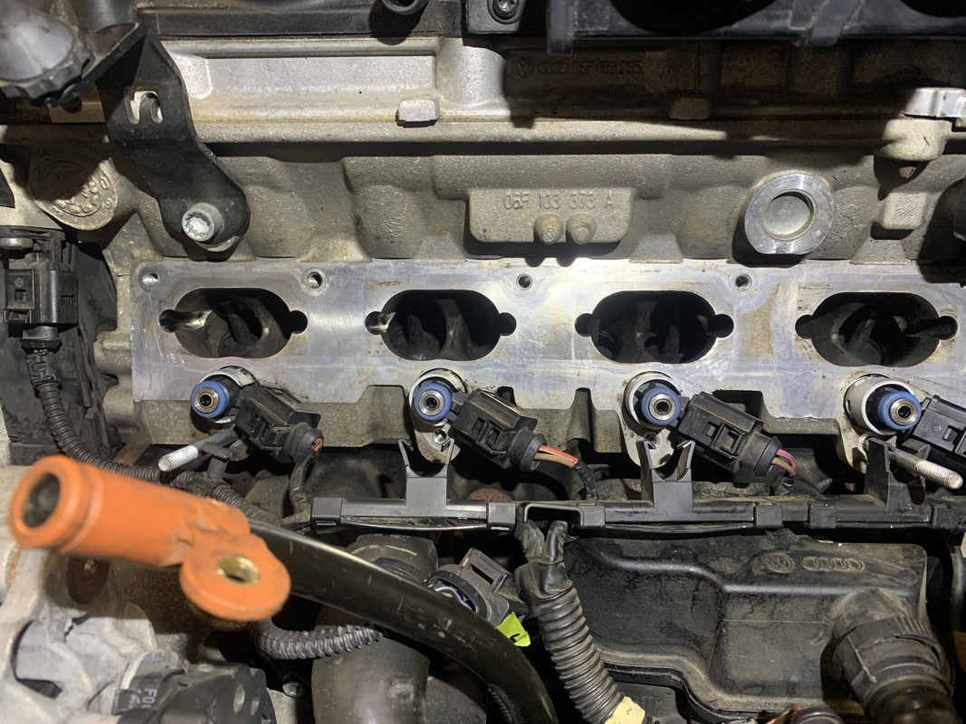

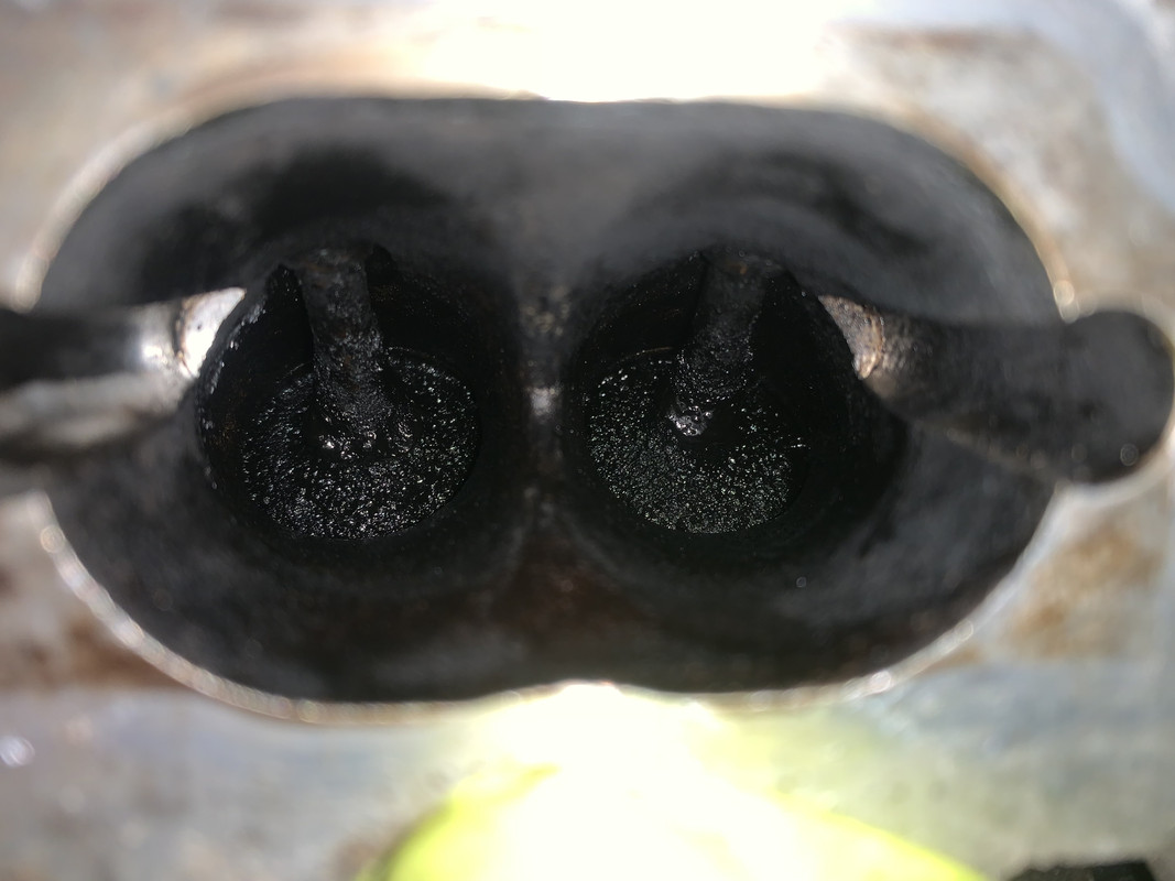

It was time for a carbon clean so I got all the new gaskets and brass brushes I needed and went to work, took about an hour and a half to take the manifold off, I fortunately did not have the dreaded Satan bolt so the intake was off in no time, I spent the rest of the day cleaning the valves. My valves weren’t to bad actually just a little build up in the middle but very easy to clean just time consuming.

While the manifold was off I installed my RS4 FRV and runner flap delete, these were straight forward installs, I fully removed the motor for the runner flaps to save weight. When the car was all back together I noticed a different induction noise and little burbles from the car. Start up’s weren’t bad it was on the colder side in the mornings I just let it settle for a bit longer but apart from that no major problems not even a fault code.
