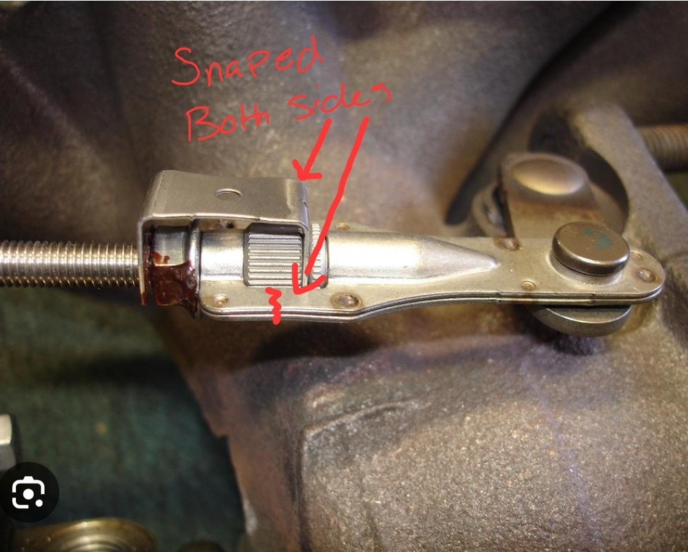

So after another inspection I may have found the problem or atheist part of it.
It's the turboactuator where it connects to the wastegate it has snapped.
Offline Northern_ED30
  • Posts: 59
Re: Help please. No boost and rattle noise
« Reply #22 on: June 20, 2023, 03:29:31 pm »
Ah, that's your Actuator adjustable link end.
Easy replacement I'm sure, so your wastegate has been stuck open?
I've found a 2nd hand manifold from a breakers for 40 quid, injectors were caked so replacing them. Think we're good to go after that :)

Offline Onethreelee
  • Posts: 21
« Reply #23 on: June 20, 2023, 05:00:14 pm »
Yeah looking for a replacement now.
