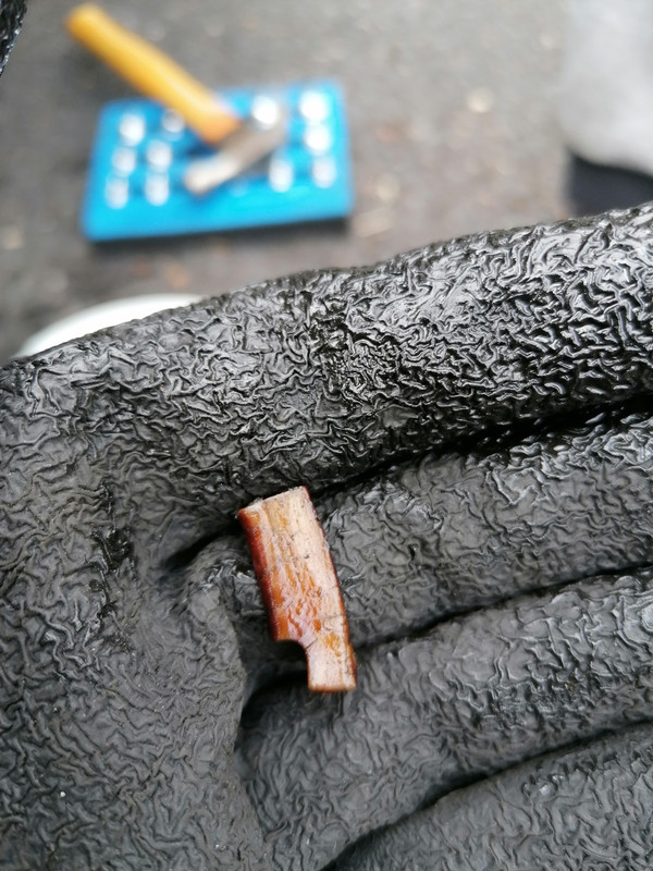

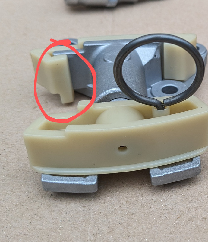

Just wanted to throw in a little side-by-side comparison that solidifies the plastic piece mystery, the notch on the bottom matches the broken off piece exactly. Any ideas why this would have spontaneously broken off in this place in particular? I don't think the chain had ever been changed, so I doubt it's from a botched repair job.

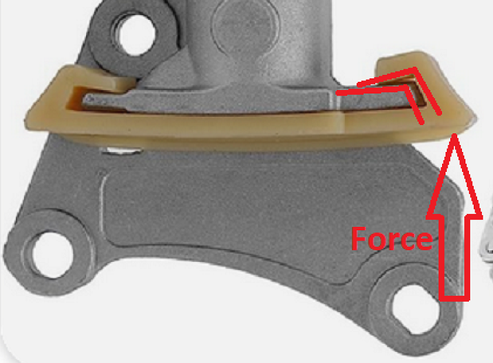

Looking at it, I can only think it has to do with the direction of force applied to that portion of the pad, albeit minimal force, and the mismatch of angles here;
There's been a noticeable number of pads breaking there in the exact spot.
Then the other additional factors one might think of: brittleness of pad material__time and heat cycles__any stress applied during the assembly of the unit...etc.
