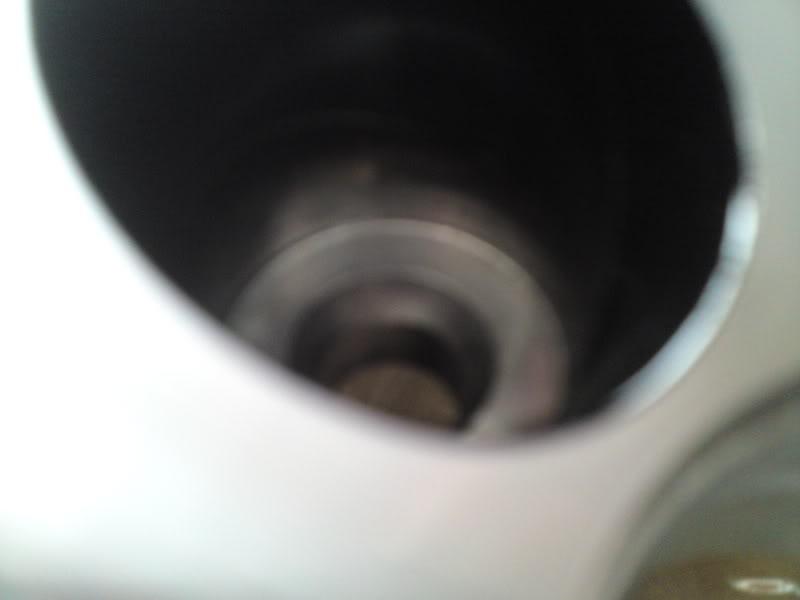

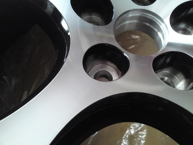

The bolt hole at first look seemed as though it was flat, but it appears there's a little curved ridge.
I've done my best to capture it on my LG Renoir which is 8MP but it's not the best at close up pics;
You can just see the ridge slightly but I'm not sure if it's enough? It's something I want to be clear cut about, following my previous experience.
Thanks chaps  :smiley:

They're taper cut so don't use the standard VW radius bolts. Get some new bolts  :happy2:
