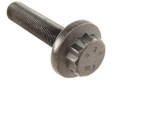

The torque value and angle are the same for the new 12 point bolts (part no. WHT005437) as for the old 6 sided bolts: 200Nm then 180 degrees.
The lower value quoted in the Haynes Manual for '12 point bolts' actually relates to 12 point bolts WITH RIBBING on the face of the head. Illustrations and full details on this link:
Volkswagen Workshop Manuals > Golf Mk5 > Running gear, axles, steering > Front suspension, drive shafts > Removing and installing drive shafts > Removing and installing right drive shaft with (push-on) constant velocity slip joint
http://workshop-manuals.com/volkswagen/golf-mk5/running_gear_axles_steering/front_suspension_drive_shafts/removing_and_installing_drive_shafts/removing_and_installing_right_drive_shaft_with_(push-on)_constant_velocity_slip_joint/
Distinguishing features between twelve-point head bolt with ribbing and twelve-point head boltwithout ribbing.
The twelve-point head bolt are only distinguishable on the contact surfaces -arrow A- and -arrow B-.
I - Twelve-point head bolt with ribbing -arrow A-
II - Twelve-point head bolt without ribbing -arrow B-
– Install wheel and tighten bolts or nuts → Chapter.
Specified torques
Component Specified torque
Swivel joint to cast steel suspension link
t Use new nuts
60 Nm
Swivel joint to sheet steel or forged aluminium suspension link
t Use new nuts
100 Nm
Drive shaft to wheel hub „twelve-point head bolt with ribbing“
t Use new bolt
70 Nm + 90°
Drive shaft to wheel hub „twelve-point head bolt without ribbing“
t Use new bolt
200 Nm + 180°

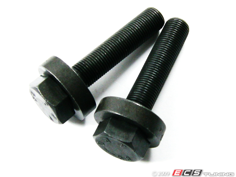

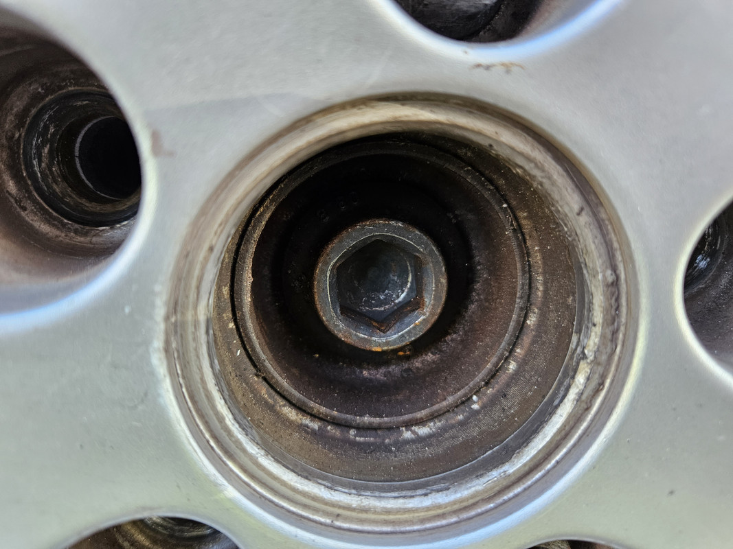

I bought an SKF set of outer CV joints and they came with the old style bolt, the old ones on the car were an 17mm allen hex which caught me off guard as who has one of those!  :scared:
Offline terrier
  • -Receive: 41
  • Posts: 437
  • My Ride: GTI now gone
Re: torque for front drive shaft bolt
« Reply #13 on: October 15, 2023, 05:37:26 pm »
Someone been there before you :signLOL: No washer,flanged bolt  :thinking:
