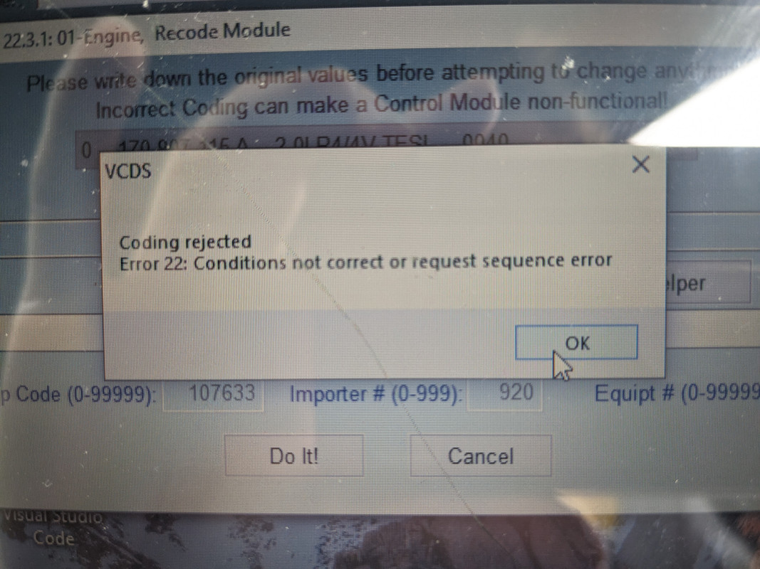

Worked the first time. But got 'Cruise Control - Defective' error code in Steering as well as 'please check dtc memory of electric load controller after coding' in Engine. So faulty coding I gather. Test drive also fruitless, cruise control not working nor CC light on dash. All other stalk functions work.

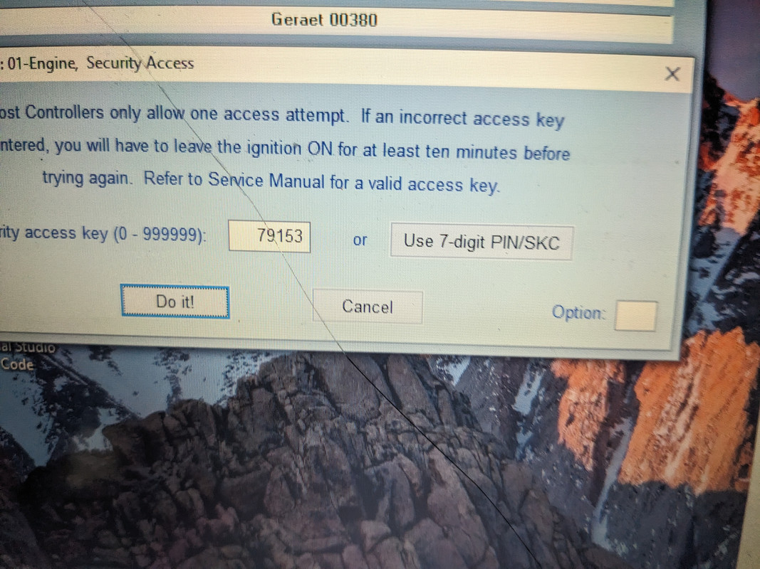

Attempted to unlock Security Access in Engine. Used codes I found online, 12233 and 79153 and neither worked.
Tried undoing and redoing the Long Coding Helper checkbox and got this message:
Anyone know how to get that pesky Security Access code?
Cheers  :smiley:

I found the code 27971 online. This said "security access accepted!" but apparently nothing changed.
A briskoda post says to set the workshop ID settings, but that did nothing either. That poster has the exact same situation, shame he never posted an update.

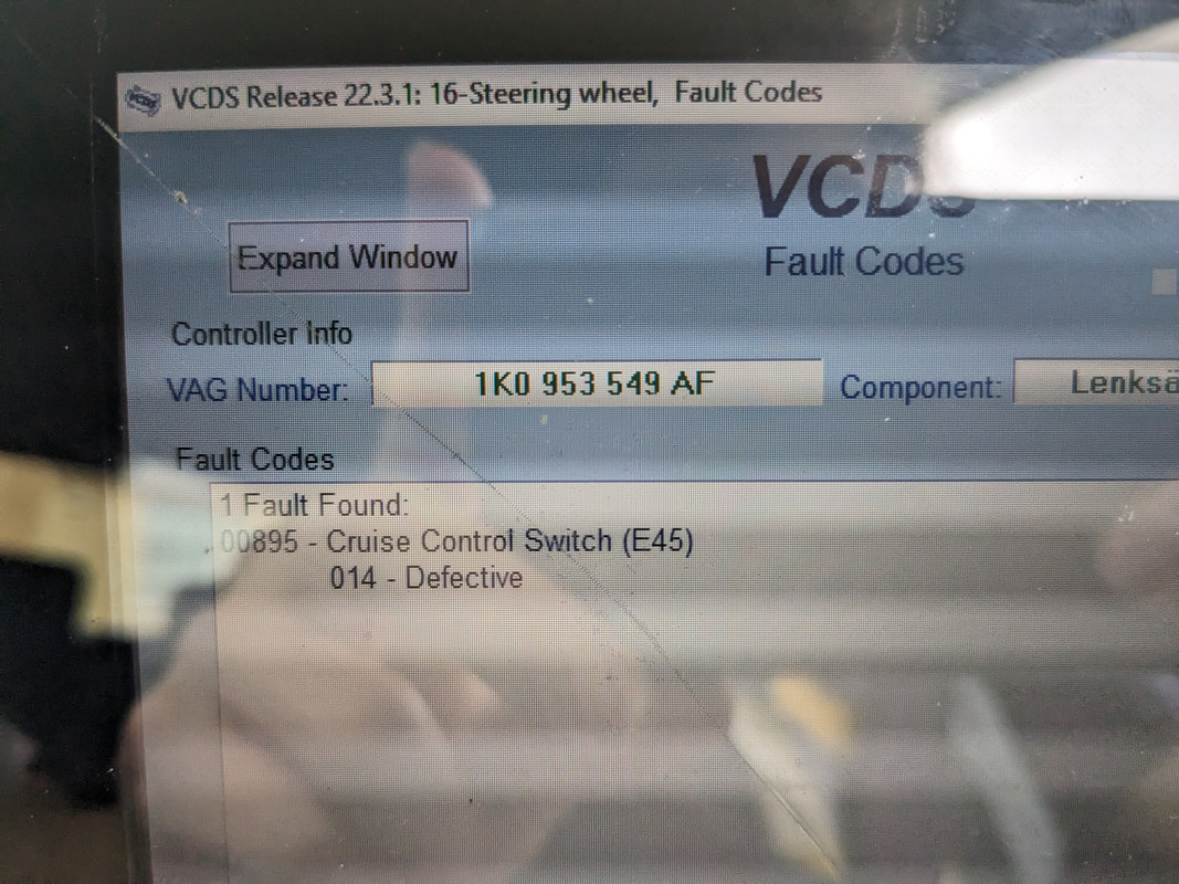

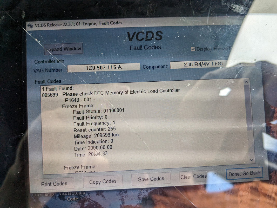

Forgot this in my last post, I have this code in Steering wheel fault codes.
I looked up the 005699 code on Ross-Tech's site and it has a special note regarding my engine, 'When found in 2.0l TFSI (AXX/BPY/BWA etc.), check Steering Wheel Electronics for Cruise Control related Fault Codes and general Cruise Control Functionality' which led me to the code in the photo below, 00895.
I now believe the TOPRAN branded cruise control stalk I bought is faulty. I'll try get a less-crappy brand one and see if that works.
