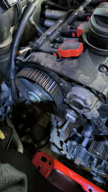

The cam sprocket is 2 teeth away from the mark but when I try and line it up it springs back to 2 teeth away.
Now it's sprung forward a quarter turn..
Going to take the valve cover off.
« Last Edit: August 27, 2023, 02:17:41 pm by dazza »

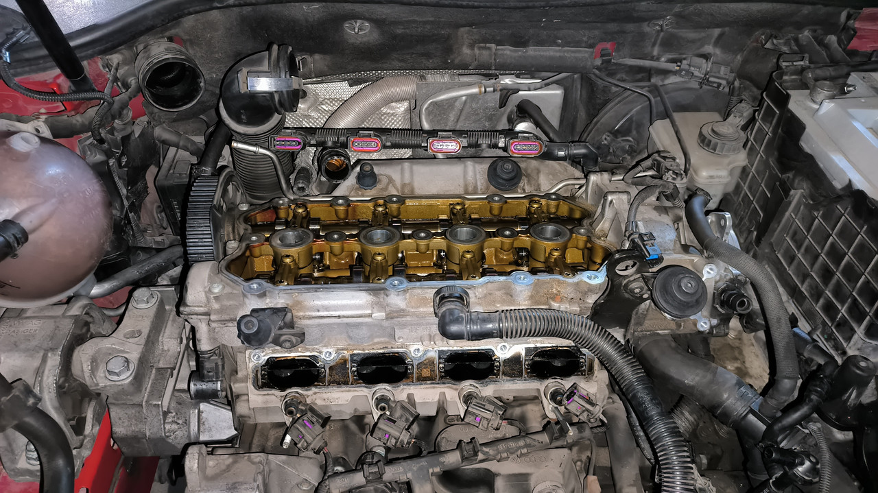

« Reply #18 on: August 27, 2023, 10:58:24 pm »
I started to remove the head. But I was thinking maybe it would have stayed at tdc if I removed the plugs?
What should I be looking for now the rocker cover is off?

I'd remove the cams and check the rocker arms that are under the cams for cracking/damage, then remove the head and check for bent valves, you may see that some of the valves aren't sitting right with the cams out.

At TDC, the rounded notches in the cams should both be horizontal and all 4 cam lobes on cylinder 1 pointing up.
